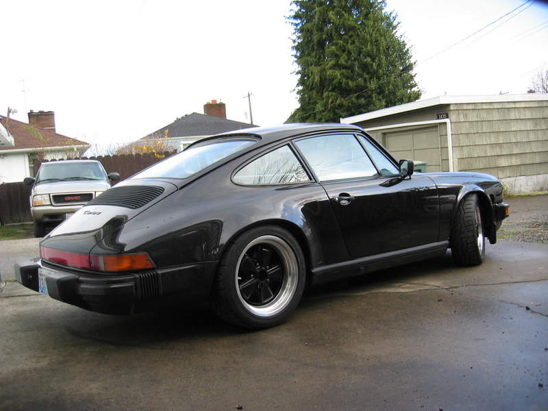

Part VIII - The Multimedia Extravaganza
Some gratuitous exterior and interior shots. The keen observer will note that those wheels are my new Rota Foxes, shod in 225/45/17 and 255/40/17 Falken Azenzis RT-615s. No rubbing so far, and as you can see, my car is below euro height.
http://forums.pelicanparts.com/uploa...1199575359.jpg
http://forums.pelicanparts.com/uploa...1199575385.jpg
The Recaro SRDs totally rock:
http://forums.pelicanparts.com/uploa...1199575407.jpg
I don't know why I don't pull out the rear seats, but I never seem to be able to get myself to do it. And if you're curious, that's a Speedware harness bar. I use 6 point restraints at the track, mostly because stock belts make me nervous at 125 MPH, and that's not the time to be distracted:
http://forums.pelicanparts.com/uploa...1199575425.jpg
