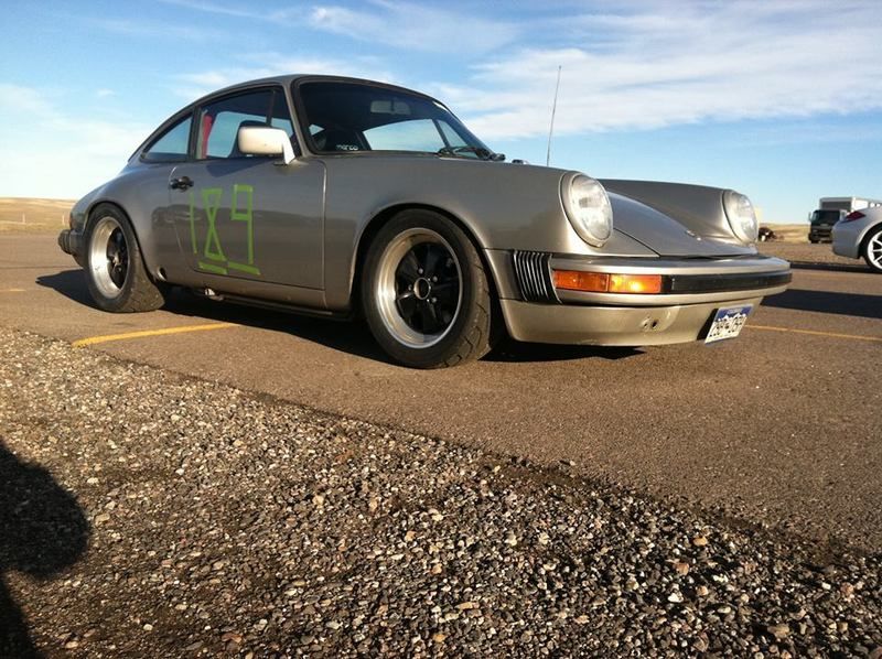

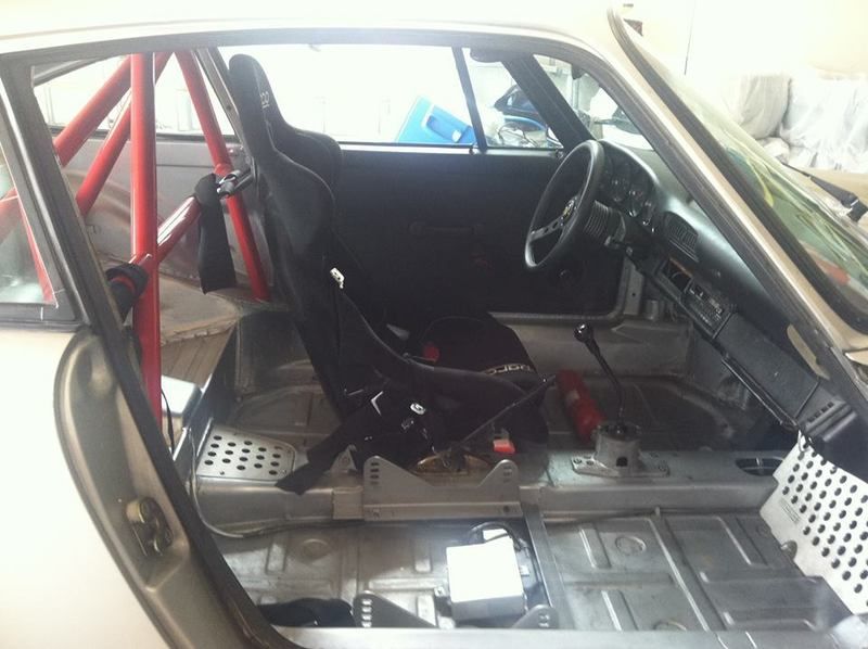

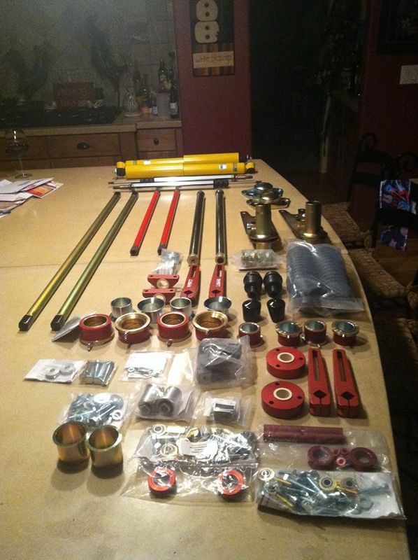

Over the Past few years I have gone from a stock 911 sc to a bit of a weekend hot rod / light DE car.
We were able to do a full elephant racing suspension setup and loose around 300lbs, the car has been incredibly fun on the track and a total riot during the weekends and longer road trips (a few Porsche parades)
the only issue was the strait line speed, the car is awesome in the corners, but ever strait we would get passed by the newer cars. a few months ago I was able to bite the bullet on a 95 vram engine with 39K miles.
I wanted to make this thread to show some progress, but also get a bit of help with the engine swap. here are a few pictures and a few questions

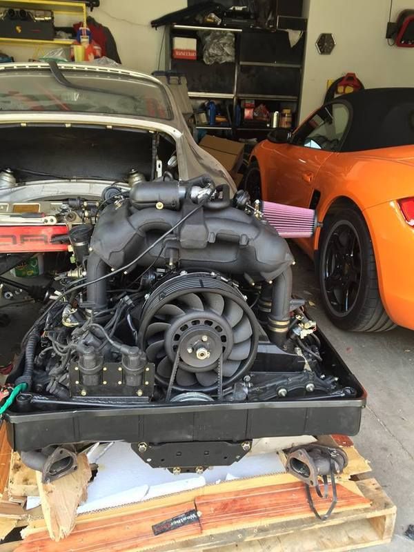

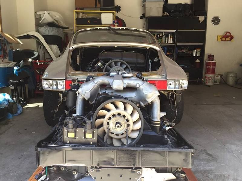

and of course, the new engine
to this

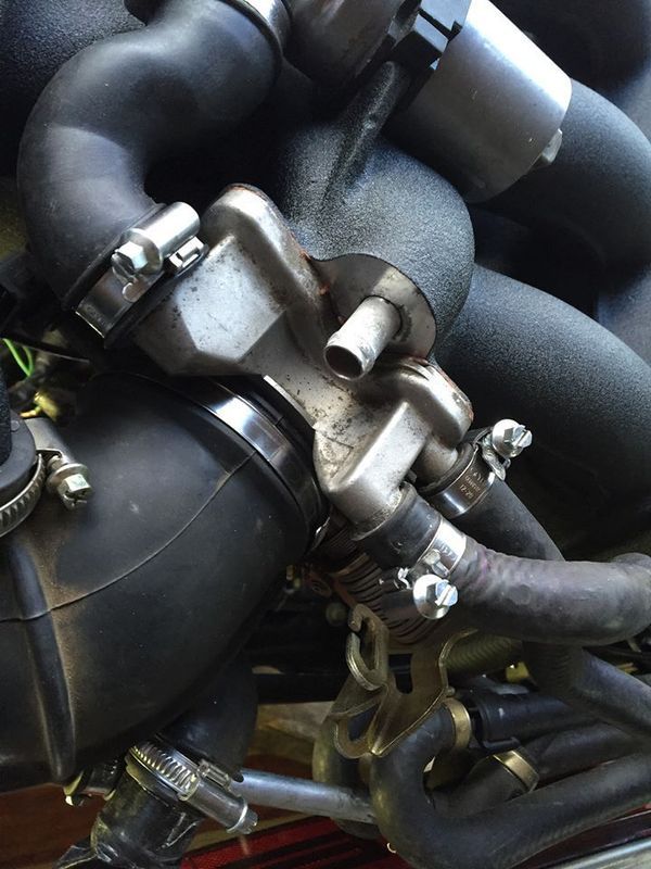

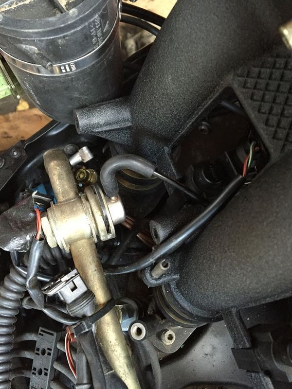

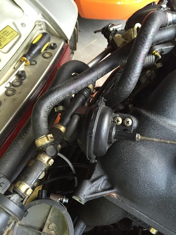

Originally Posted by -Levi- View Post

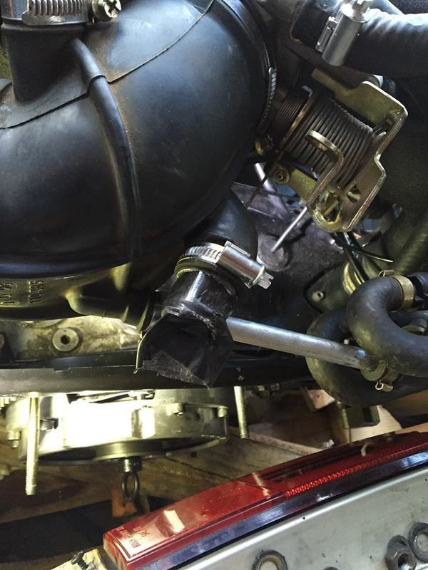

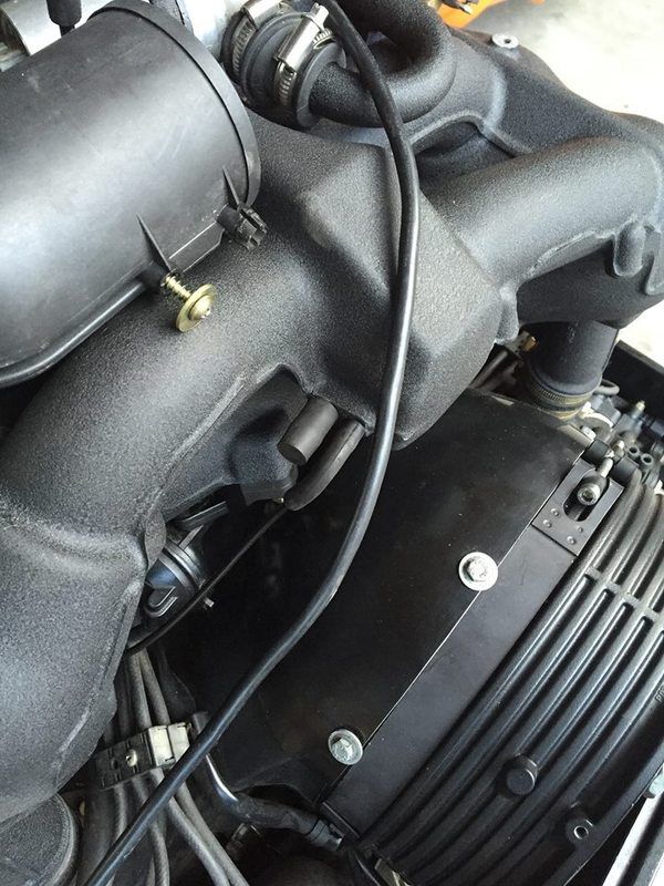

my plan is to have the engine installed this weekend, I should be all set other than some v-ram vacuum lines-
unfortunately all the pictures I took while taking everything apart for powder coat were lost when my phone was stolen, I'm just not positive I have things correct. any help is greatly appreciated
# 1 the vacuum line coming off the intake manifold (next to the capped off one, goes rubber to plastic vacuum line. does this line go to the picture below on the fuel rail?
From ^
to V
# 2 is this setup right? do the two canisters link this way? with that, where does the vacuum line go that is hanging off the + section?
- #3 the two flaps on the top of the intake manifold, where do those vacuum lines go?
# 4 where or what do I do with this large intake opening?
# 5 Do I cap this?
Here is the vram vacuum layout

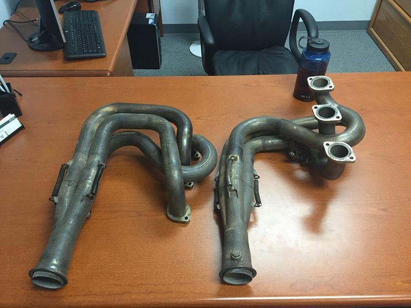

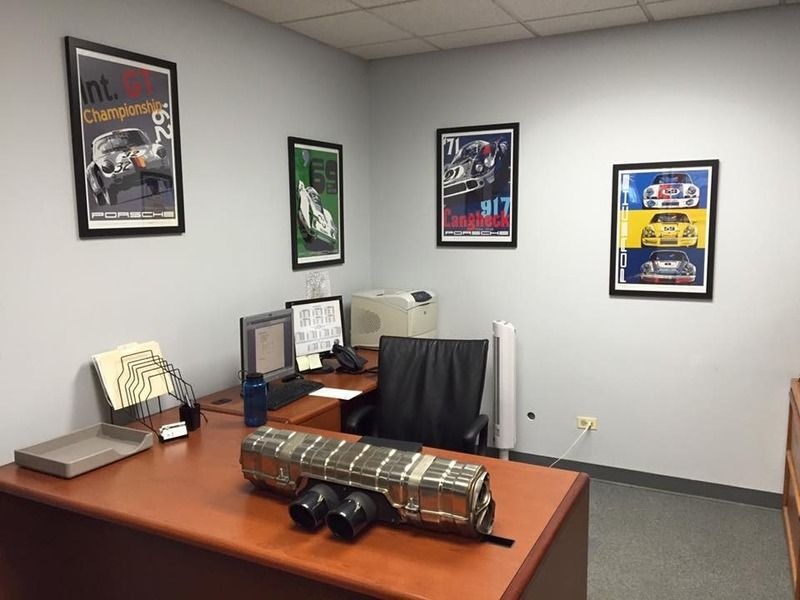

Where did you find your muffler?

I assume that the motor is a US '96-98 w/ OBD2 and SAI
That is a vent to the oil tank
When I did mine I used a RoW '97 OBD1 motor w/o SAI
here is what that area looks like on mine w/o SAI
Bill Verburg

Another oil tank vent, see above

Thanks, yeah the engines are far from cheap, in fact the engine cost more than the car was worth 5 years ago. I looked into building my 3.0 to 250rwhp or so and the 3.6 just came out better in nearly every way.
Bill Verburg
thank you for the info- ill trace the lines this weekend, they may be a bit different than stock as I'm not using everything, but I should be able to figure something out
toddu
the exhaust is a stock997 gt3rs exhaust I will have mated to s-car-go race headers, the goal is to have an electronic cut off to have two different exhaust paths= one street one track
Bill Verburg
this engine is a 95 with vram conversion. I like the idea of obd1 for its simplicity-
thank you so much for the pictures! you are the man! so the two big lines vent to the oil tank? if so, do you know why? it seems like it would be more of a risk for oik to go into the intake if over filled vs a filter on the oil tank- or maybe I'm seeing this wrong.
0396 the engine was converted to v-ram, not removed.
Bill Verburg
Here is the oil system, the dashed lines are the ones you asked about.
Yes, overfilling is a no no!
Bill Verburg

Im liking your exhaust plans, been tempted to do the same.
