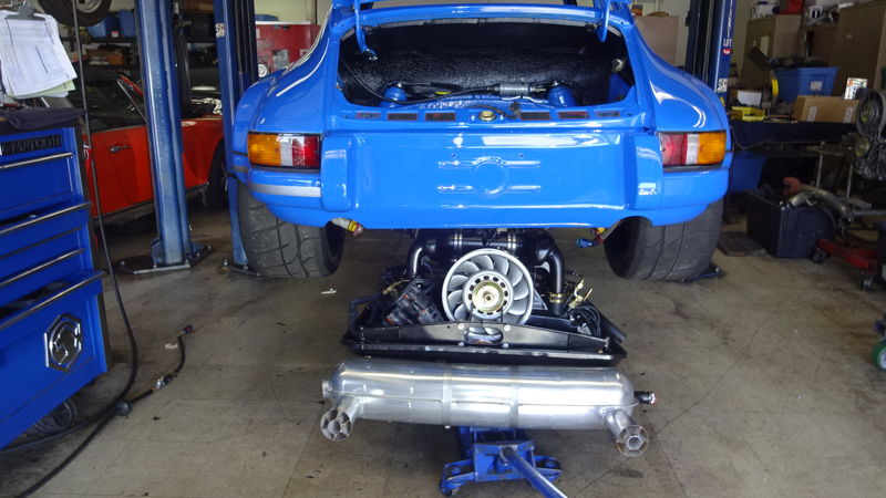

Motor in Saturday. Fortunately I did a freshen up for the previous owner less than 10 hrs ago last year before I bought the car back. Lower end is 993 with Carillo rods and Clevite rod bearings. Heads are welded up around perimeter to prevent cracking. Aasse spring and retainers just in case of missshift. 964 injection with later plastic intake and custom chip. Makes 275 wheel hp. Was great to see the car with suspension compressed and sitting right.

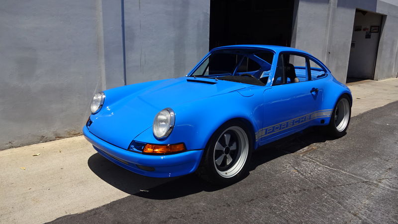

headliner and windshield in. I can finally drive without ski goggles. Bit the billet for Clearbra on fenders/bumpers also. Motor/trans much smoother without solid mounts.

Interior almost done. Still fighting with quarter window seals. Glass guy left drenched in sweat and practically in tears after fighting to get one in last week. Dealer seals on the way next. Jims upholstery in San Diego did upholstery last week. Headliner kit came from pelican and fits great.
