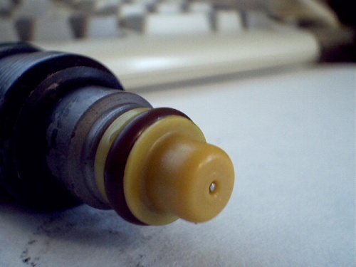

Remember you posted a picture of your mod injector cap? I'm changing all 4 now but the injector kit I got from Pelican Parts has that same cap with that small hole. Did your car run without making the hole bigger on the injector cap?
Here is you picture you posted. (Without mod)

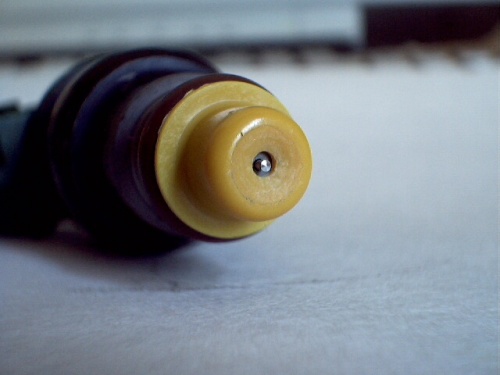

(With mod)'

I didnt run the ca without making the hole bigger and tappering it. The car is only needed to protect the tip of the injector. Just take the sharpest drill bit you have and with 2 fingers cut away the tip. It cut fairly easy. Also, as before the car ran just fine with the modded caps.
