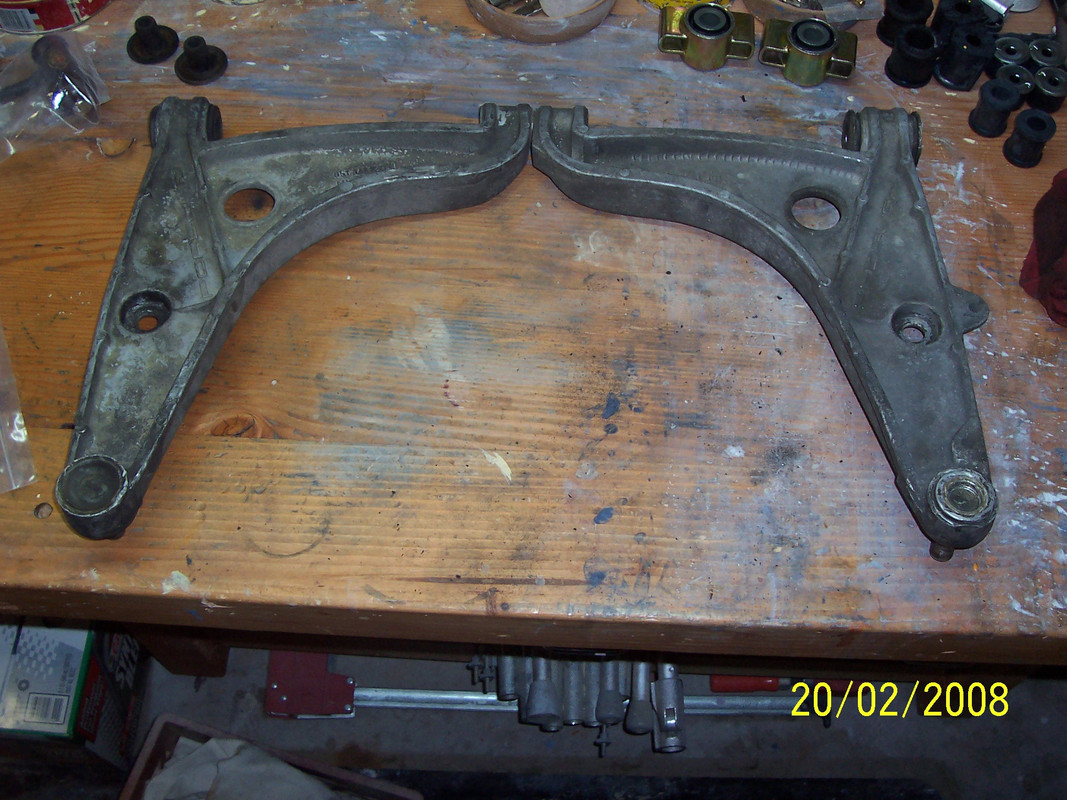

Having removed the control arms from my ‘87NA project…I discovered that one of these looked a bit different (see on left in photo below) - featuring an additional hole and tab (with hole).
Digging a bit further about this version of aluminum control arm, I come to see that I cannot use the currently available ball joint kit…that in fact a ball joint replacement is impossible. Is this true?
Kind of pissed that of the two control arms, it is this later version which exhibited a torn boot. But the ball still looks good, and seems to operate smoothly - so I guess I’ll just add some grease and install a new boot and hope for the best. At any rate…as a heads up for those who might not know this, here are the two versions of the late aluminum control arm (newest, “non rebuildable” one on left):

And what about the later piece renders it non-rebuildable? Different ball or something?

They are fully sealed from below with no epoxy or snap ring/way to remove the ball and socket from below as with the rebuildable aluminum arms.

I have posted about this multiple times over the years.
Left = rebuildable, Right = non-rebuildable:

Just my two cents. I may be wrong but it almost looks like someone swapped out one of your control arms at some point with a 968 control arm. I notice the castings are slightly different and I believe the 968 control arms are NOT rebuildable.

That is what it looks like to me as well.
Doesn't the newer (1987 n/a --> on ) have a part number that starts with 951.XXX.XXX.XX ?

All new arms are the 968 type.

Yup...my car's history indicates that this control arm was switched out in 2002 - along with a phone dial wheel, so there must've been some kind of impact.
At any rate...bummer that this newer style arm cannot be rebuilt!

I bet that something suitable is out there. Many newer cars have cartridge style ball joints. . .just need to find something that will fit there after some machining.

I was wondering if 944 online dot com might have a solution and indeed they show rebuilt arms, 87 and up for $295 (and new for almost a grand each). They are good blokes at solving problems for these cars and have likely come up with a solution like Rasta suggested.

John, the 944 online folks are indeed great problem solvers - but the price you quoted assumes the exchange of a rebuildable core, otherwise add 200.00.
Rasta...was thinking also that there must be something out there like that - but I'd be leery of too much messing with aluminum at such a critical and stressed location.

So they wouldn't take your 968-style arm?

Here are some options I found with a google search.
https://www.boostbrothersgarage.com/products/high-strung-944-tubular-front-control-arms?variant=34522469171244
https://www.ogracing.com/products/fabcar-racing-control-arm-4
Racer's Edge -- Racer's Edge Geometry-correcting A-arm NEW!

John - generally to be accepted as a "core" the part in question must be rebuildable. But I'll phone Ian or Steve next week to discuss.
AZ - those arms look amazing (as well as high $$), but not necessary for my street-only driving. But thanks!
