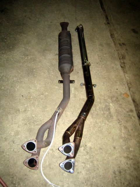

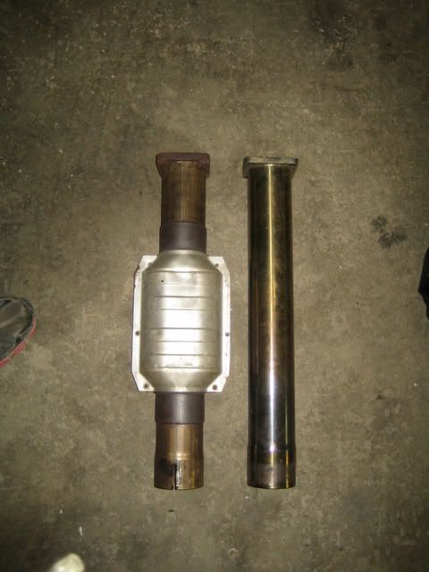

Techno Duck 10-01-2008 10:04 AM
Crawl under the car and see what the cat looks like. This is what the stock cat looks like..
http://img.photobucket.com/albums/v1...4/IMG_5637.jpg
http://img.photobucket.com/albums/v1...4/IMG_5636.jpg
Most aftermarkets will look like this..
http://img.photobucket.com/albums/v1...o/IMG_5749.jpg
BTW, i have heard of brand new cats going bad after a few years. Pretty sure most were 'off' brands also. I think the best brands are CatCo, Cargraphic and Magna Flow.
EMBPilot 10-01-2008 10:20 AM
jon it looks identical to the bottom picture on the left.

they put a new cat on the car. the O2 readings went down to .2 (from 1.0). The other readings came WAY down too; HC went down by 100 units (50% decrease), CO went down .50 units (90% decrease), CO2 stayed almost the same.
