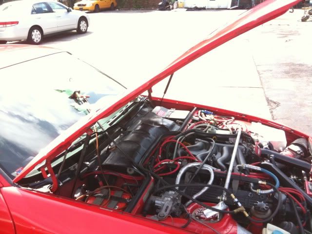

Greetings fellow 944 fans! I'm new to the forums and very frustrated with my 951, as i'm sure we all have been!
I've been poking around on the forum and I haven't found my specific issue fully addressed but i'm sure it's been discussed many a time, so if this is a redundant repost, please kindly point me in the right direction
My Issue: *I HOPE YOU'RE READY TO READ...TAKES BIG BREATH*
Car goes completely lean after a few seconds of boosting (kicks, pops and looses power)
Back Ground Story:
I purchased my 86 951 a few months back. When I test drove it, it would only boost to about 9 psi and ran at the correct AFR's, but it didn't have very much power. After taking it home I discovered 3 large boost leaks (hole in the cold intercooler pipe and two rubber boots were torn)... After I fixed the boost leak the car would (and still does) after a few seconds of boosting, run lean enough to not support combustion. Even when I run it at the same 9psi or lower it acts like it runs out of fuel.
The fuel pressure feels EXACTLY like it's running on an accumulator and after a bit, it runs out of umph until you take it easy for a few seconds (10 or so) fuel pressure seem to "recharge". *NOTE: the issue may not be fuel pressure but that's what it feels like*The car seems to run better and not run lean as quickly once it's up to operating temps.
The car idles and cruses smooth and at the correct AFR's (maybe a little lean) but anything over 0 manifold pressure it will lean out after a few seconds. Keep in mind, the AFR's will remain correct at even 6000rpm as long as it's below 0psi. The car is also very very sluggish when cold with horrible throttle response.
Here's What I've Done So Far:
I've drained the fuel, installed new fuel screen, new fuel pump, new fuel filter, new stock fuel pressure regulator, pulled all 4 injectors and cleaned them. Rebuilt the waste gate and shimmed it, boosts to about 14 psi now. I've tested and cleaned the stock MAF (temp sensor or door) and it checked out perfectly. Tested all the coolant temp sensors, I found the one w/ the two open prongs to have an OPEN with NO RESISTANCE so I used a variable resistor to simulate a working temp sensor (300 ohms) at the applicable temp but it made no difference. I've used a smoke machine to locate vacuum leaks, the only one that i found was a minor leak through the throttle body shaft. I took out the DME and the KLR and cleaned the connections, the tube had no kinks. The DMEhas a tuned chip (MAX HP KIT 95 DME III) but lindsey racing told me that is was just as good if not better than their tunes. I also installed a new DME/FUEL PUMP relay (no difference)
I'm at a total loss and i'm quite discouraged by this car.. It normally takes me 30 seconds to diagnose and issue but this car has me STUMPED.
Any help would be GREATLY APPRECIATED!
my two last ideas are:
Possible low voltage to the fuel pump
or Bad DME or KLR

First off, are you sure the vacuum line for the fuel pressure regulator is connected to a port on the intake manifold?
I would check your fuel pressure as this will save you alot of trial and error. You should see about 36psi at 0 manifold pressure. Then you should see 1 psi increase per psi of boost.
Monitoring your fuel pressure while running can be a pain, but you can get creative with a temporary solution.. .
Assuming you do not see expected fuel pressure at boost, as you already figured i would check your voltage at the fuel pump at full load.

Hmm, if it's really a fuel-flow issue:
1. Test total fuel-flow volume. Remove cap @ end of fuel-rail and connect hose into bucket. Turn car on or jumper DME relay to turn on fuel-pump. You should be getting massive flow like 2-gallons/min.
2. Check fuel-filter
3. Test FPR as TechnoDuck mentioned. Pressure should be about 36-38psi @ idle. Then increase by psi per psi of boost. So with 10psi boost; you should have about 48psi fuel-pressure.
Monitor that fuel-pressure when you floor it and it dies. Does fuel pressure change just before or after the stumble?

Sounds like a leak that's opening up under boost. Take apart the intake from the turbo-outlet to throttle-body and inspect every single piece of rubber. The thin intercooler hoses can split underneath the hose-clamp. Also the conical hose going into throttle-body can pop off as well since it has a very thin clamp and clamping area.

Update:
So, today I was working on my A/C and recharging it. I got it blowing nice and cold but when I was about to take off the a/c gauge lines I noticed I heard a hissing sound from under or near the air box.. so i fumbled around and picked up the air box to see if there were any vac lines underneath and the whole MAF JUST FELL OFF! So MAYBE that's why it's acting like the MAF isn't working! i'm really hoping so.
When I was messing with the intake J-tube, I found out it was leaking and torn in 3 spots... And a I tore 3 different hoses/lines... And I broke the coolant tank. I swear I wasn't being rough with it, everything just seemed to be brittle and old :/ so it looks like i'll be spending about $300 tomorrow. Crossing fingers! I'm keeping an optimistic attitude

Ah... so the AFM wasn't connected to the rubber J-boot? That's quite a leak!
That explains the super-lean mixtures when it stumbles, the turbo's sucking in air after the AFM and the AFM is registering zero airflow. DME injects zero fuel. Damn old rubber and plastic parts are so crispy at this age. Get a metal J-pipe, custom-fab it if you need. Saves you a tonne of troubleshooting later.
