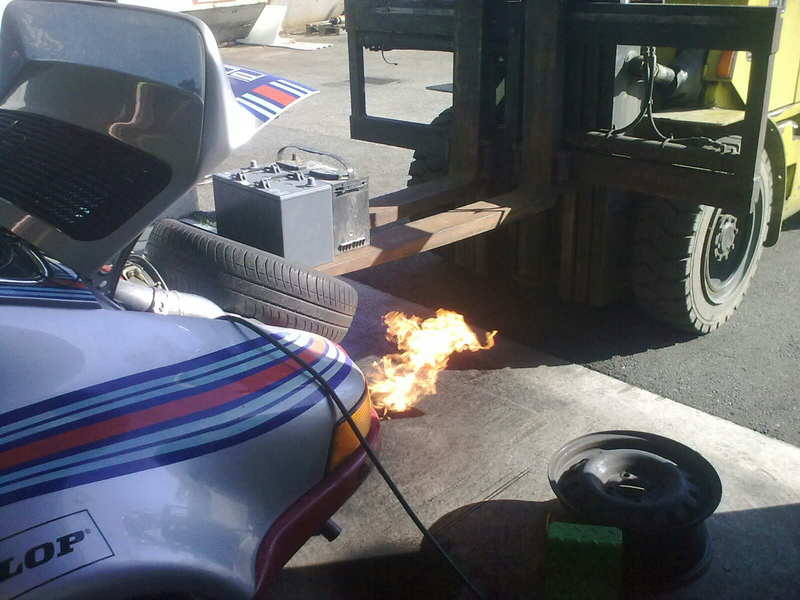

Interesting, does any one know how high exhaust temperature a 930 ca stand and over how long time?
I was testing my 930 today, but i had problems with high exhaust temperature.
In my car i have haltech ems, 3,2 cylinder heads, 3,2 plenum, efi, 964 turbo pistons and cylinders 3.3, a larger turbo that have air up to 600hp.
Car was running at 4000 rpm, boost around 0,8 bar. When running like this the exhaust temperature immediately vent up to over 900C (1700 F) i gave the engine more fuel and it dropped to 880 C (1600 F+) and would not go lower. I tried several times by more fuel (11/1), delay the ignition (8°), etc
Air temp after the intercooler was around 35C (95F)
But exhaust temperature wouldn't go lower, i think this is too high exhaust temperature.
I tried to give the engine so much fuel that it was flames out the end pipes.
What do you say, is this high exhaust temperature ok? what can be done to lower the exhaust temperature?

Barbecue!
Old 06-12-2009, 04:07 PM
Tinkering Pays!!
mooney265's Avatar
Location: New Orleans
Posts: 1,375
Ok, so I'll be the first to ask: "What is going on behind your car?"
1. A Fork Lift
2. 2 Batteries on the skids
3. A spare tire resting on the engine
I give up?????
1. A Fork Lift
I give up?????
Keep weight on the rear end to prevent the car from coming off the dyno? I believe he did say 600hp.

Hi
yes we used the fork lift to give more weight on the rear end, the car started to spin on the dyno when reaching 5500 rpm 300 kW (400 hp).
It was frustrating that the exhaust temperaturee became so high, I didn't dare to advance more to get take out more hp at high rpm. So we tired to run at 3000 rpm using variable load.
I did run the engine too hot and when cooling down on idle i got problem with the crank sensor that became overheated (sensor give signal to ems for spark, etc). New sensor is now ordered.
Next time i will remove the rear bumper and get some more large fans over and under the car's engine area. Now we only had a large fan in the front of the car.
I have never had a exhaust temperature senor on before and i wanted to control the temperaturee when converting to EFI. Sorry now that i didn't look after this temperature when i used CIS for reference.
1500 °F is wanted i agree, but on a air cooled 930 engine what is happening in the real life? what heat can the engine stand in short periods?
