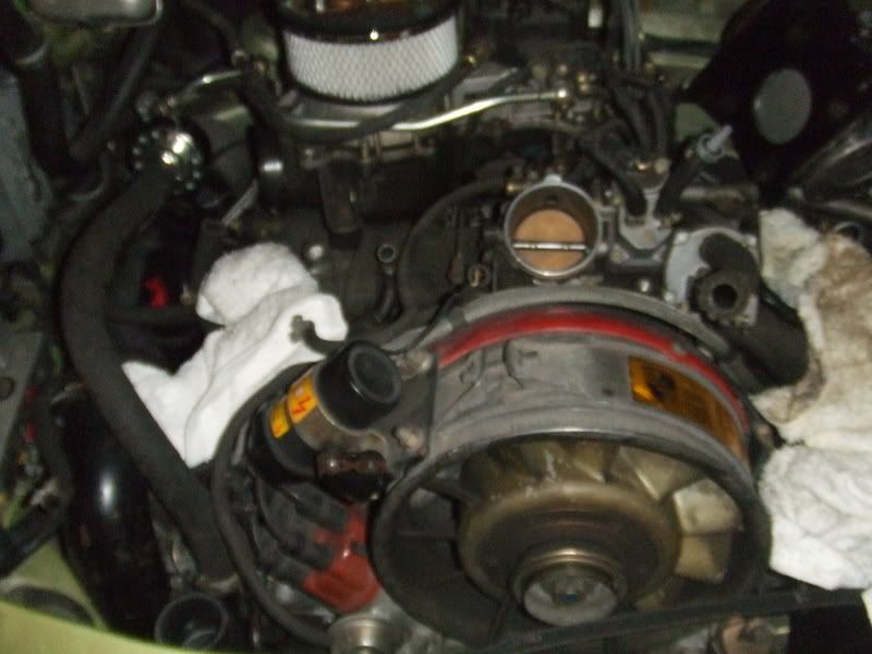

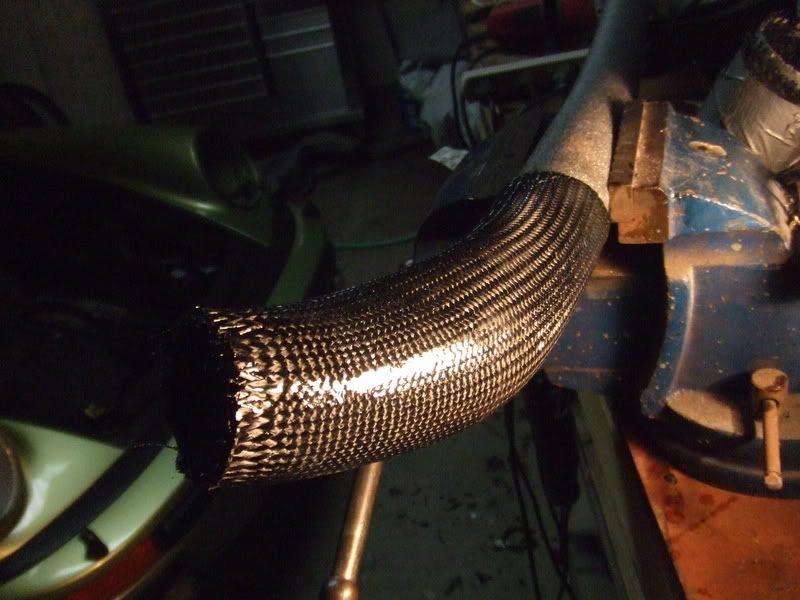

mdurbahn 01-16-2008 06:56 PM
Pic Update :)
Here is the tube from the turbo to intercooler, I made it using carbon fiber and foam backer rod for a mold. I still need to trim to end so it fits right and looks smooth.
http://img.photobucket.com/albums/v5...0/DSCF0857.jpg
Here is the naked engine...
http://img.photobucket.com/albums/v5...0/DSCF0860.jpg
And here is the prize awaiting installation.
http://img.photobucket.com/albums/v5...0/DSCF0861.jpg
Still need to purchase a c2 bpv and make the tube that fills the void of the old bypass valve.

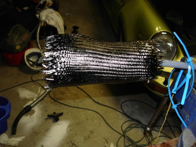

mdurbahn 01-18-2008 06:17 PM
thanks jay, I want to check out yours too. I am making the other reducer tube right now..had to make that one out of carbon fiber too because I dont have a welder :)
It's not dry in the pics so it doesn't look as good as the first pipe yet.
http://img.photobucket.com/albums/v5...0/DSC02421.jpg
http://img.photobucket.com/albums/v5...0/DSC02420.jpg

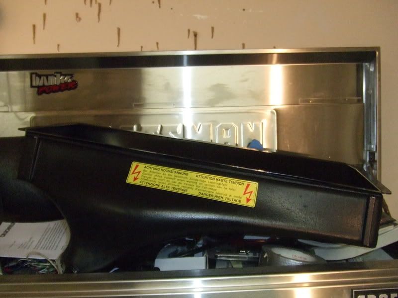

mdurbahn 01-19-2008 03:50 PM
Test fitting reducer tube:
http://img.photobucket.com/albums/v5...n/DSC02425.jpg
Have a couple more questions now.
1. do you need to take the a/c condensor out of the tail?
2. what's the easy way to take the rear wiper assembly out?
I don't want to try to close the lid until I know I won't have any clearence issues..
thanks!
