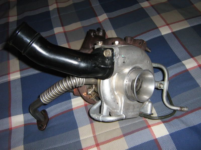

BARknucklehead 06-03-2009 03:43 PM
A decision has been made on turbo selection! I just sourced this bad boy:
Mitsubishi TD05HR-16G6-10.5T From The Lancer Evo VIII.
http://i25.photobucket.com/albums/c7...n/IMG_1160.jpg
http://i25.photobucket.com/albums/c7...n/IMG_1161.jpg
http://i25.photobucket.com/albums/c7...n/IMG_1162.jpg
http://i25.photobucket.com/albums/c7...n/IMG_1163.jpg
Here's the compressor map - it's good for over 400HP:
http://forums.pelicanparts.com/uploa...1244068173.gif

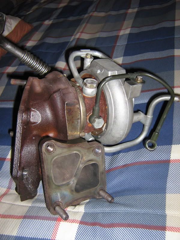

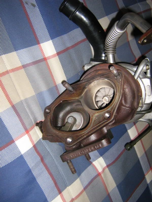

All of that power and lightning fast spool up for $300. Not bad. This is a dual scroll turbo, so I am going to have some stainless fun fabbing up the equal length pipes from my headers into the split mouth flange sometime soon:
http://forums.pelicanparts.com/uploa...1244068302.jpg
You'll notice that you need to keep the two exhaust banks completely separate until after gases exit the turbo to reap the benefits of twin scroll:
http://forums.pelicanparts.com/uploa...1244068877.jpg
