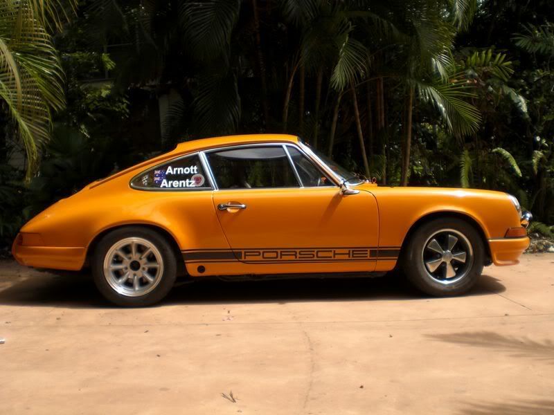

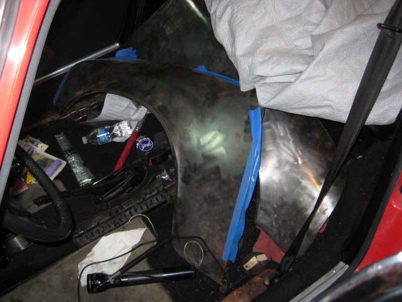

So when I decided to buy this car the two things I didn't want were things I knew I could eventually fix: the car was originally silver (this was my first choice!) and flares, well, that's just a grinding wheel away from being half fixed!
Needless to say, the first thing I did after tearing the motor apart was to remove the RS flares.
So when garage space was low, I did what I could in the driveway. This was the result of a half days work on a summer Saturday:
Free from their captive state:
The whole thread of flare removing endeavor
And happily in place in their new home down under:

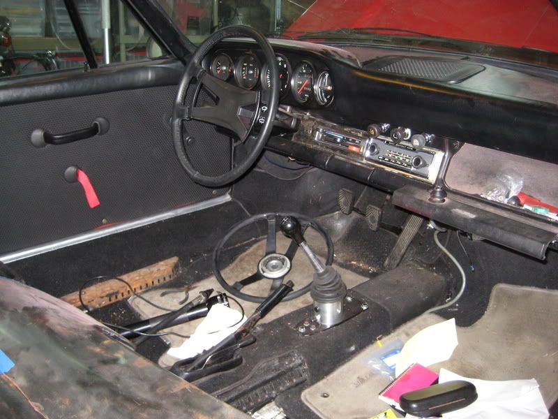

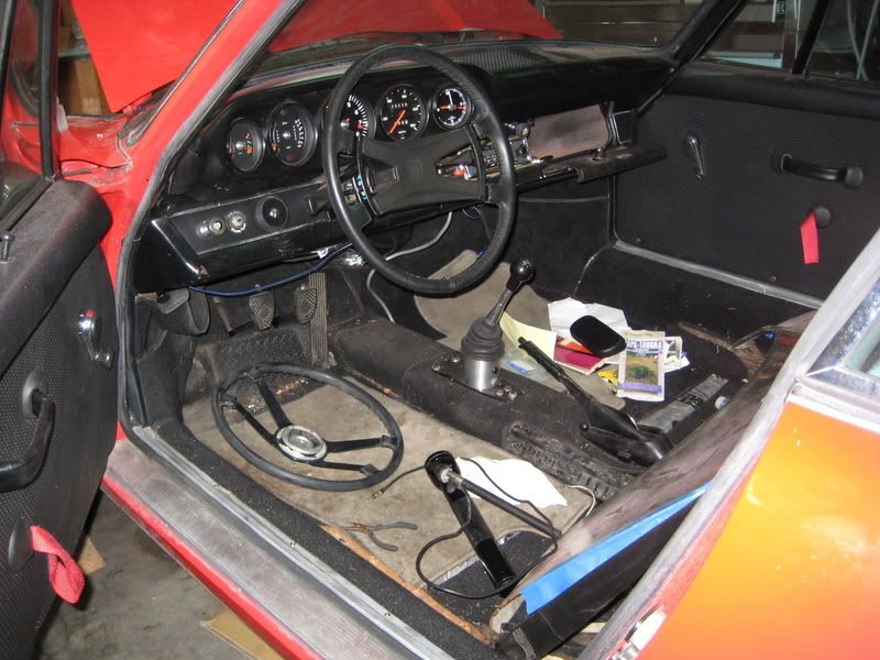

That brings us up to the present. Here is the baseline view of the car:
Let the fun begin!

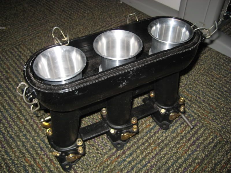

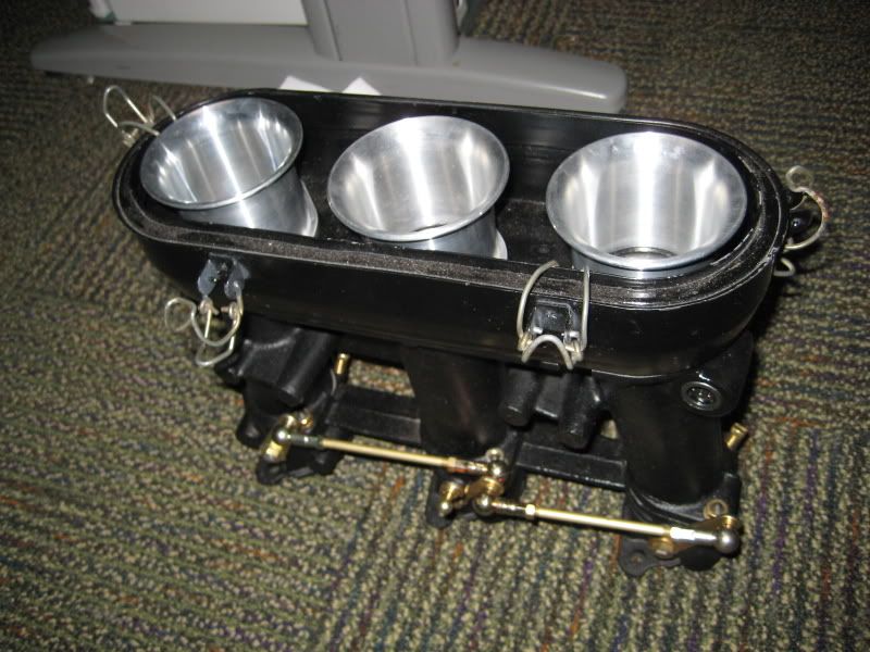

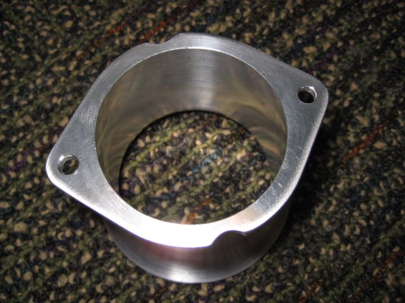

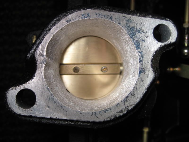

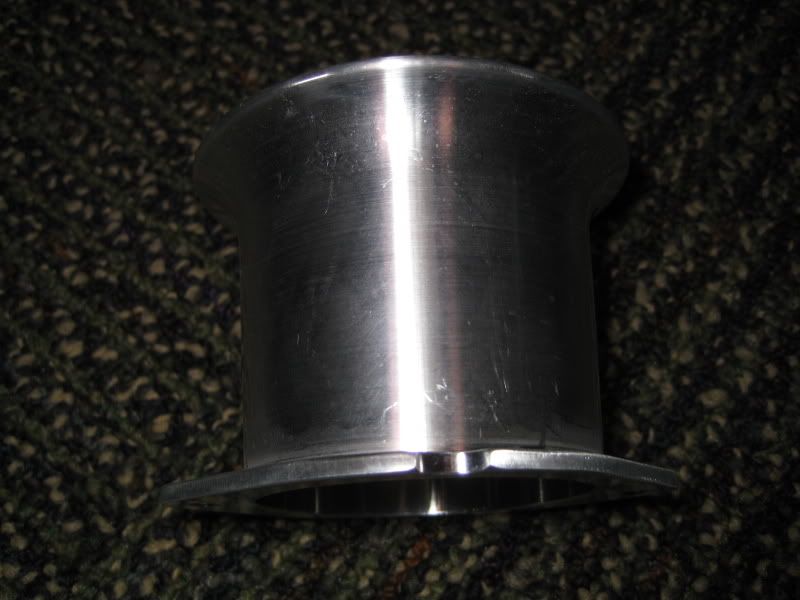

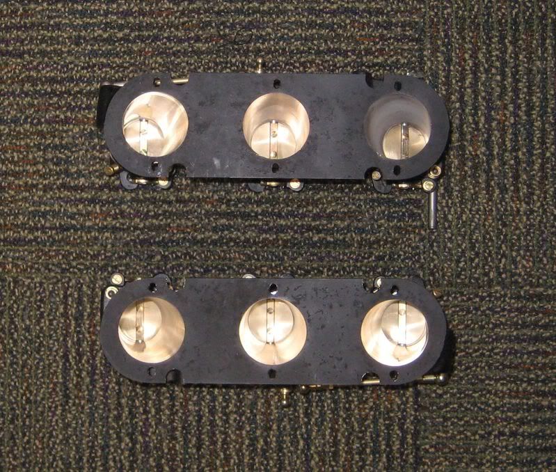

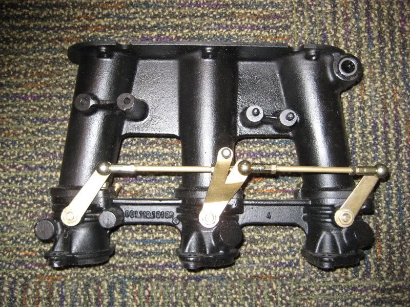

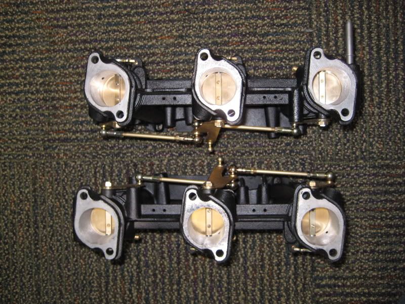

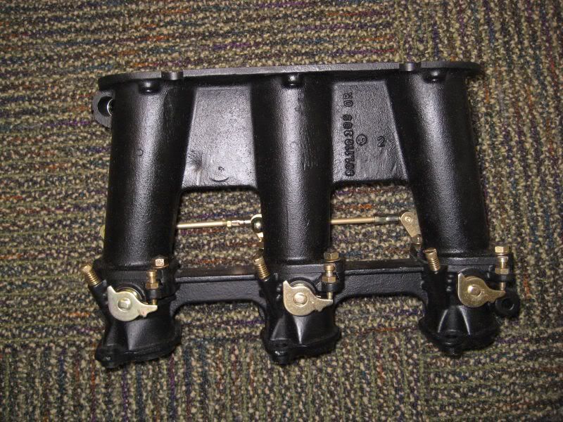

Reposted from another thread to tie things together.
My MFI:
These TBs are the work of Aaron B, better known as "Burn-Bros" on this forum and of the twin plug dizzy fame. For context, this was an R&D project so don’t ask me if he'll do this kind of work for you, how much it cost or anything of the like. I want to give him credit, but at this point he wanted me to let everyone know up front that he isn't interested in soliciting work at this juncture.
Basic details. This MFI is for a 2.3L, modern take on a first generation 911ST motor. You've all seen my specs. You've also seen the heads, which were a major driver for the unusual bore spec for a motor this small. By unusual, I mean that these stacks taper from 52mm at the top, down to ~39mm at the throttle plates, through the irregular ports. The bottom line is that the entire intake tract acts like a tapered venturi from the top of the MFI, all the way to the valve surface. Air velocity of this set up is entirely against the laws of intuition - and equally eye popping.
Take special care to notice the irregular contours of the bottom of the TBs into the intake head bores. My heads have an irregular, custom shape and Aaron took the time to match taper these by hand for a perfect transition.
That said, time for the show!
The TB surface.
The port.

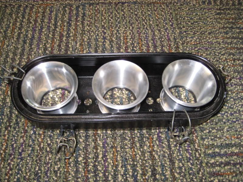

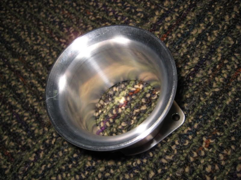

More details; the custom spun aluminum trumpets:
