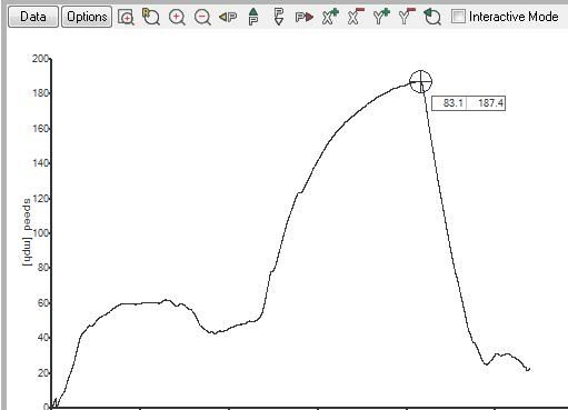

JBL930 07-17-2009 08:41 PM
The thin springs are there just as helpers, nothing to do with anything other than prevent things getting out of place.
When i say the car felt solid braking hard on a 1.5 mile run, check the speed of decelaration here
http://i139.photobucket.com/albums/q...30/1874run.jpg

NathanUK 07-19-2009 01:22 AM
The helpers are right Jonathan, on most 'normal' :) cars they do go at the top.
Oh, would like to see the time on that chart you posted too :)

JBL930 07-19-2009 09:23 AM
I see what you are saying, maybe the thickness of the compressed spring is just enough? Would be a bit of an oversight if it isn't.
Here you go Nathan, this was the first VMax event since the new engine has gone in, i wasn't pushing the car too hard, i could have braked a lot harder but i was frightened of locking the wheels. I could have also gone harder in each gear, you can see i changed to 4th long before 130mph came up, and i know i can get 134mph if i red line 3rd, plus the 60 to 130mph was around 9.5 seconds and i know if i'm agressive it will do it in 7.5 seconds . Next event i'll be lighter, i was carrying a passenger and a full to the brim tank of fuel, and i will be more agressive, will get into the 190's then. Which is quick in a old car i think :)
http://i139.photobucket.com/albums/q...0/1874run2.jpg
NathanUK 07-19-2009 03:01 PM
Yeah, that looks kinda quick to me!

Jonathon,
That's one impressive braking! Was that on big reds or stock 930 brakes?
