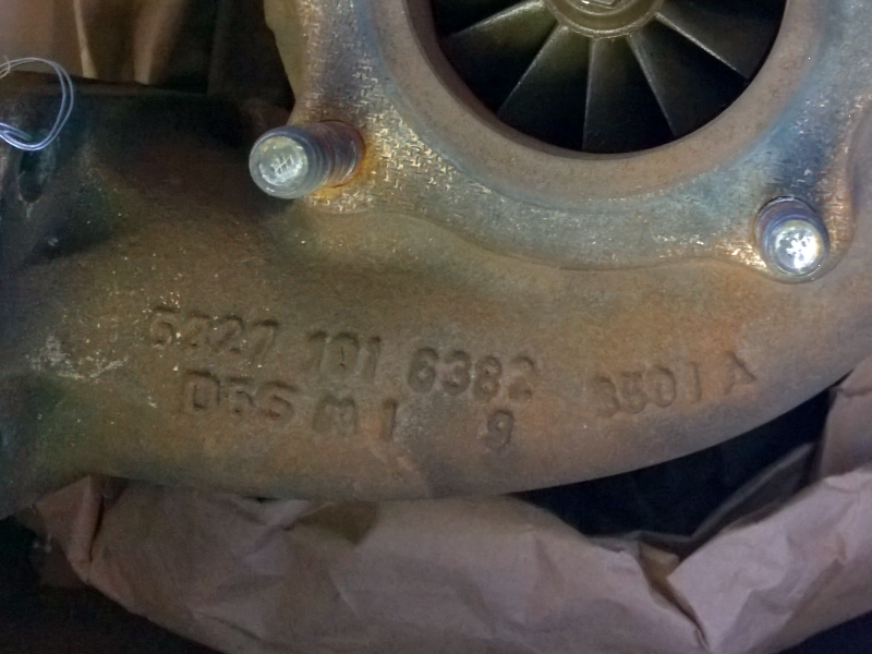

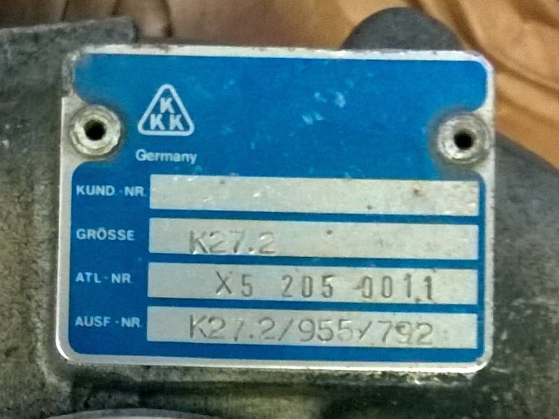

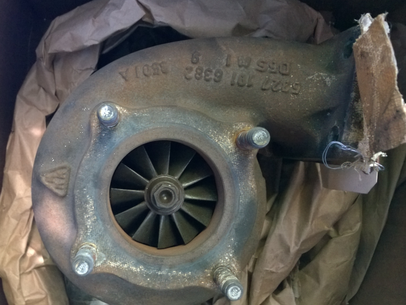

I ran across this K27 in my buddy's shop - it was amongst a collection of K27s that he bought when from Andial when they closed up shop. I can't find any reference to the turbo, as the Grosse number is not terribly descriptive. Here are some shots:
Anyone have any thoughts - or even better - qualified knowledge? I'll open it up and measure it tonight so I can at least know what the wheel dimensions are.

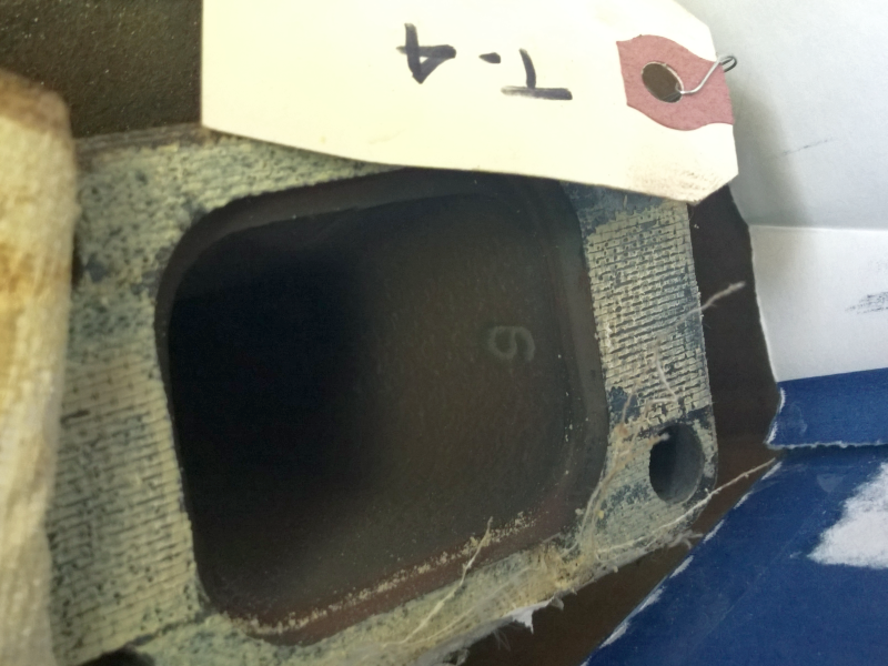

T4 is the turbine housing mounting flange size. That one is undivided or single scroll.
Stock 930 exhaust headers have an undivided T3 turbo mounting flange on them.
T3 is smaller than a T4.
