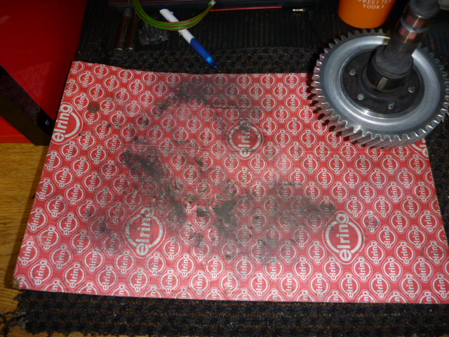

nocarrier 06-26-2019 09:31 AM
I didn't notice any mention of pulling the plug and flushing the intermediate shaft.
nocarrier 06-26-2019 09:35 AM
http://forums.pelicanparts.com/uploa...1561570340.JPG
This is how much gunk came out of one.
