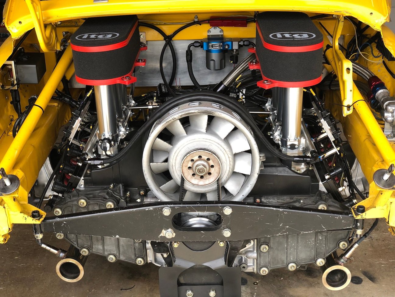

You won't be sorry with the MoTec M130. I think I was one of the first to get an M130 setup from Rasant. Andrew has been great to work with.
I went with the WeaponX CoP setup.
I went with Injector Dynamics ID1050x injectors. They would work great for you as they have more than enough flow capability to handle E85 and are designed to handle any fuel type.
Here is my engine freshly installed in my race car:
