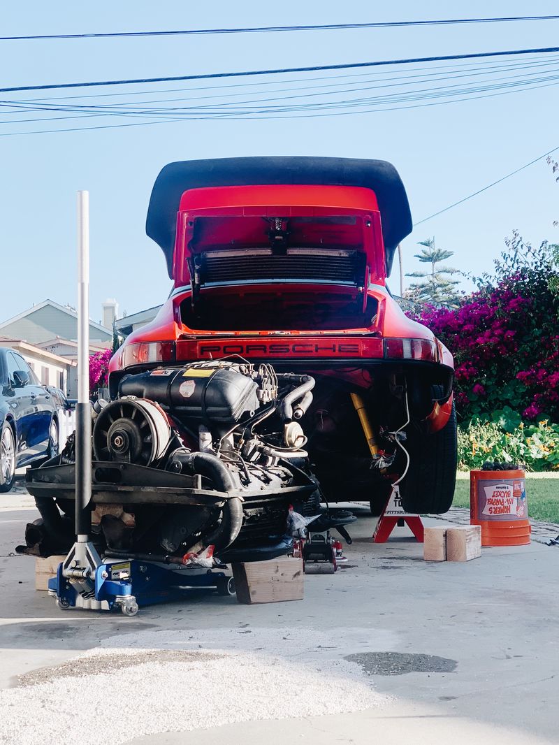

Pulled the motor myself in the driveway. Here's happy me after I got the engine on the stand. Used a chain at the cross member side and a tow strap around the rear hook to meet the chain at the front. Really easy way to get it up. Harbor freight hoist for $140, cheap and does the job great.
I found one head stud while pulling the tin. Next up was pulling CIS off and exhaust to get down to a long block. The exhaust was RUSTY. Originally a Michigan car. All 6 Allen key nuts came off no issue, the 13mm nuts were a different story. I took a Dremel to all 6 to split them open and whacked them with a large flat head and hammer to pop them off. The studs will get replaced to didn't mind grinding into them.
After pulling the manifolds, cross over, and cat in one piece, I worked on the lower valve covers. Found 4 broken head studs in total, even though the car ran great before pulling it.
