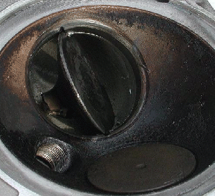

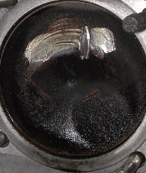

so here is the results of my tear down. Looks like I got away with damage to the No. 3 piston, but the valve is bent.
As you can see the valve isn't seating and the top right of the piston was only 'grazed' judging by the small amount of scouring visible.

What is the deal with piston within the red area. Is that a camera lense distortion?

must admit, I noticed that earlier, just after my posting, dosen't look good though. Hope it is a distortion. So I need to check it out. Will do that tomorrow and report back.
Perhaps another case of the novice not seeing, which is something I've become aware of - rather like the therapist and the client - we can only see whats apparent when something has been brought to our notice - the experienced eye!.

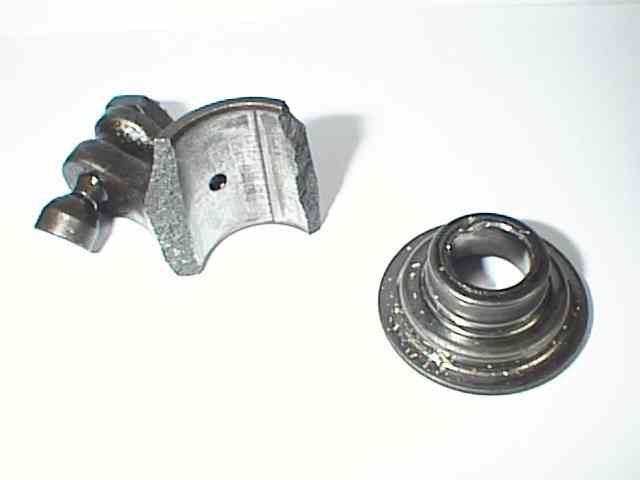

Bad news on the engine, Tom, but your excellent shots have earned their place in .....Doug's Mechanical Mayhem Files.

Here's another couple of shots of the same piston, looks like it was a camera distortion - I'm glad to say.
Doug I've included another 2 Pic of the broken valve spring and rocker arm, just in case you can use them in your MM compilation.

And one of the other part of Rocker arm.

Excellent work, Tom!
In the future, a legion of shameless devotees of destruction will thank you!

I don't think it's just camera distortion. In the second set of pics, you can still see some evidence of burning of the piston crown. This time it's at the bottom of the piston, since the pic was taken from the other side. You definitely need to pull this piston and have a better look.

Well, sounds like it doesn't matter then anyway. That's good. Upgrades always help alleviate the pain of the rebuild, since your getting more than what you had in the end.
The pistons burn, generally, on the exhaust (bottom) side of the piston and closest to the cylinder wall. But it can happen anywhere there is a hot spot due to detonation, leanness, overboost, lack of cooling, etc. A burned or bent valve can cause this hot spot, like in your case.

The "distortion" looks to me like a puddle of oil. I believe the picture is upside down.

I agree with you, when I returned to inspect the piston, I looked at how the oil puddle may have affected the photo (there's no substitute for being there), and could see how this may effect interpretation. However this does not represent any disrespect for Tysons input re - piston burn.
I do wonder though, about piston burn and weather this could occur after the spring had broken and the intake valve became bent, finishing in the closed position (which it was), possibly pushed there by the piston hitting it. possible consequence to this would be that, running at high revs (on track) the fuel mix (if any got to No. 3 cyl) would run lean???.

Interesting pics, indeed. I don't think it was from a lean mixture, but from inadequate cooling across the cylinder 3. Check out the cooling fins when you get a chance. They maybe clogged with crud. It looks like the engine had a serious oil leak on #3 for some time.
Dave
