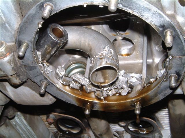

Yikes, is that a piston pin in the bottom of the engine there? Can you send me a larger size pic of that for my archives (wayne@pelicanparts.com).
$500 and you can't go wrong. $1000 is a bit more riskier, but you still probably won't get hurt if the thing is junk (you could part it out and sell the useful parts on eBay, etc...). Both numbers would include the CIS too...

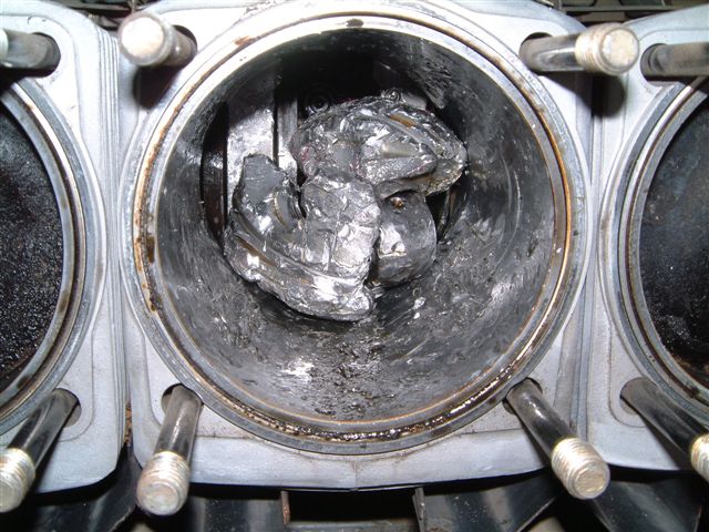

That picture is my engine, and it turned over very nicely, with no noise, and had no external signs of damage. I would guess it would've looked like a pretty good engine if you didn't look inside or do a compression test.

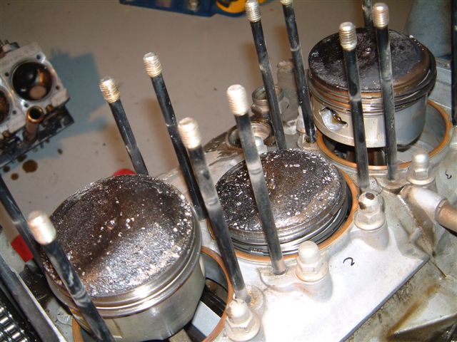

I didn't take that many pics. Here is a larger pic, plus 2 more:
http://www.dleong.org/scratch\sump.jpg
http://www.dleong.org/scratch\sprinkles.jpg
http://www.dleong.org/scratch\cylinder.jpg
It was a pretty benign blow, and I did not expect the final result. Neither did most people who examined it in the field. Hardly any noise. no smoke. Running 5,000RPM at the time.
The theory is that a cylinder was running lean, and destroyed a piston, but no one really knows.
The schrapnel went into the intakes via the PCV, and that is why you see metal sprinkles in the other cylinders.
I am looking or a replacement 3.0, since I plan to run the PRC Toyo Cup Series, and I need to stay legal. Otherwise, I would install a 3.6.
Anyone have a 3.0 engine for me?

That sump pic says it all. Thanks for posting the larger pic - I have saved it for my archives...
I would predict that *nothing* except probably the fan & housing were salvageable from that engine?

That is a good question. I haven't taken the case apart to make that determination. What do you think? I am pretty sure I have 5 good pistons, and Cyl. 5 good rods, and 5 good heads. Is 5 the same as zero? Some people are encouraging me to try to rebuild the engine.
Should I have vented the crankcase differently to avoid spreading all of that shrapnel? This was a track only car.
What makes a piston come apart at 5K RPMs?
Dave

On a normally aspirated engine, I don't think it is likely that the piston will explode from running lean. I am not saying it is impossible, but likely it ain't.
What's up with the head on the 'bad' cylinder? Any valves missing? May the piston have hit a valve first? Any damage to the other heads / valvetrain indicating jumping time etc.?
I am fairly new to the flat six, but I would be scared to use the case and crank again, ditto on the rods. Pistons, cylinders and heads can be checked easier. The shrapnell didn't scar the walls? 6 is a better number than 5, but you can always mix and match, at least from bank to bank.
If it were my engine, I'd sell the remains and start from scratch.

No missing valves. No indication of the piston hitting anything, although the evidence may be destroyed. The shrapnell was pretty fine, and maybe scored one othee cyl., but new pistons and cyl might've been be part of a rebuild anyway.
I will install a replacement engine, but then I'll have a box of parts to decide what is good and what is not.

I would clean out your oil tank chances are schrapnel is in there via your oil pump. objects that big could rip right through your oil filter. I would at least have the case and crank checked, these engines can take a beating.
