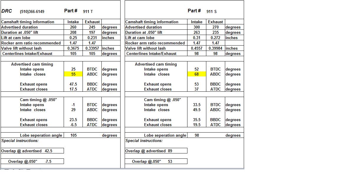

You need to factor in Volumetric efficiency.
a 911 S at 2500 to 3000 rpm is probably making less cylinder
pressure than a 911 T at the same rpms.
Does anyone have the "compression test" reading for a stock 911S and a stock 911T ?
John Dougherty
Dougherty Racing Cams

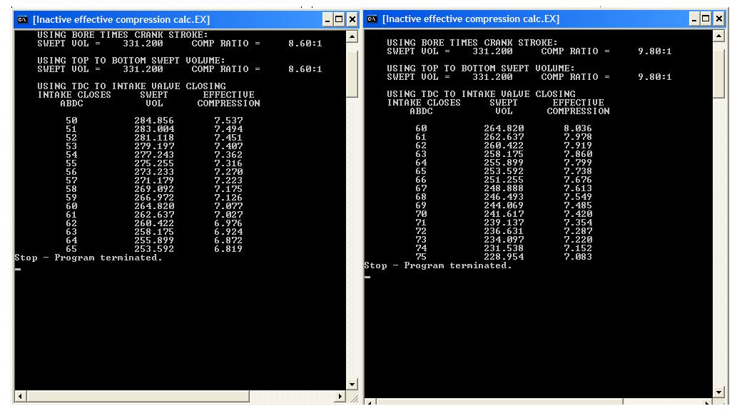

Old 12-06-2004, 04:28 PM
camgrinder's Avatar
Join Date: Feb 2004
Location: California
Posts: 926
I did some comparing, the stock 2.0L 911 T with 8.6-1 and a 2.0L 911 S with 9.8-1 compression. Knowing the valves true closing point, and the static compression ratio, I can predict the effective compression both engines will see. Of course the T engine will have less "VE" than the S engine. But this is interesting. The T running compression is 7.3-1 and the S is 7.5-1 even though the S has 1.2 more static compression.
John Dougherty
