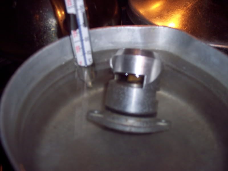

cgarr 05-04-2009 06:14 PM
this is the engine thermostat? or for the front cooler? I just tossed one in some boiling water, it started to open at around 185 and fully open at 200 The upper slot (top of unit) will be open a bit, the lower slot is the one that opens when heat is applied, try some boiling water and see if it opens? if its the one on the engine I have xtra ones if you need one.
Craig
http://i30.photobucket.com/albums/c3...1/100_8179.jpg
jaybird840 05-05-2009 01:48 PM
Craig,
It is the engine thermostat like the one you have. Today's experiment is one of the reasons that I wanted to do my own rebuild. I have a much better idea of how my oiling system works today. As for my thermostat, it seems to be working fine. I don't have a candy thermometer (that's what my grandmother called it, anyways) that reads temps that high. However, I think the thermostat is functioning fine. Here are some pics. The view is of the side of the thermostat that is normally closed at ambient temperature. The first pic is right about the time the water starts to get a little bubbly around the edges.....
http://forums.pelicanparts.com/uploa...1241556198.jpg
and now here it is at a rolling boil.....
http://forums.pelicanparts.com/uploa...1241556227.jpg
and, as it comes out of the water.....
http://forums.pelicanparts.com/uploa...1241556259.jpg
Can I assume that it doesn't open any further than this? It has about the same sized opening that the opposite side has when it's cold....
So now it's off to the hardware store to pick up a few nylock nuts to secure this, and the crankcase breather top. Thanks Craig!!!
