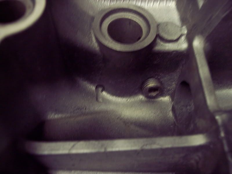

As seen in the video, what was the hole (that got tapped) for originally, and what screws in to those new threads?
1972 911T/S MFI Survivor
Old 11-05-2008, 02:48 PM
abit off center
cgarr's Avatar
Join Date: Feb 2002
Posts: 7,311
That hole was where the oil dumped into the sump from, it now gets a 1/4 pipe plug.

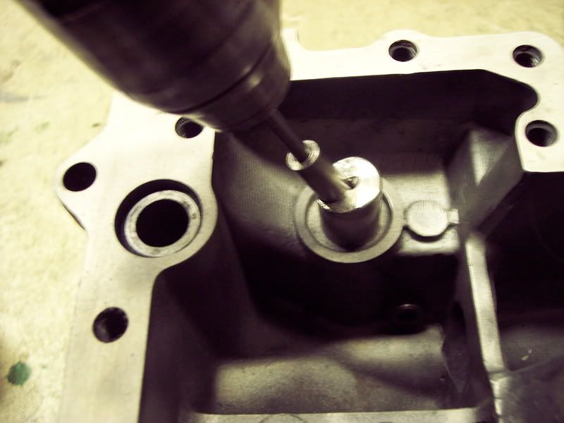

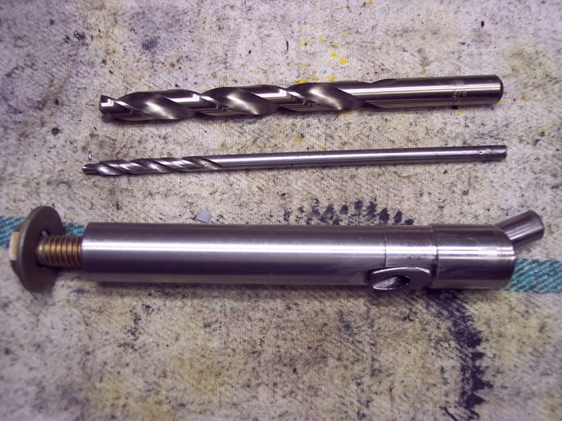

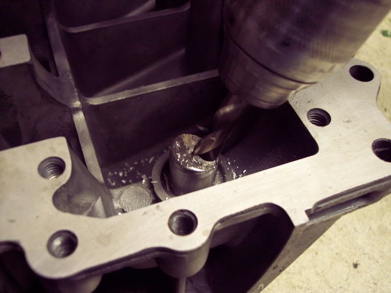

Here is the fixture G2 made which helps with drilling the bypass port. Its pretty simple, The use of the pilot drill may not be necessary but I think it does help.
The Fixture and pilot sleeve, final drill size is 3/8
Drilling the Pilot:
Drilling the 3/8 passage:
