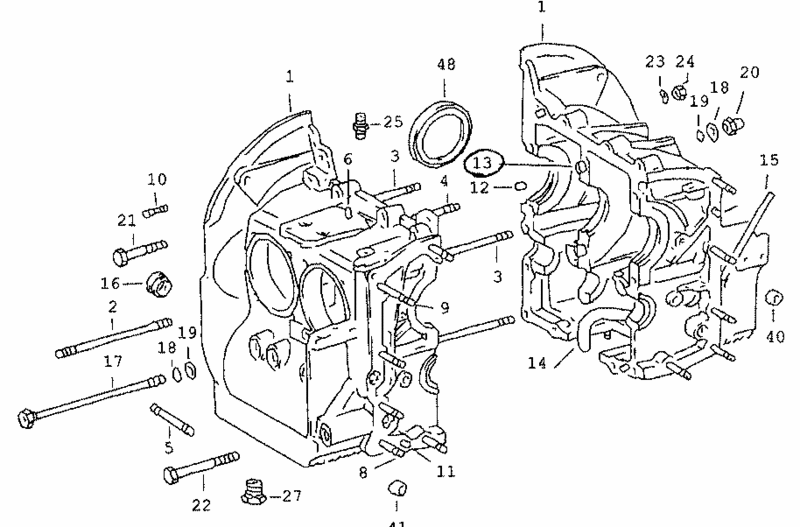

There must be a tool used to remove the two round locks in the case. Something like pliers with a smooth round surface to grasp them with. Anyone familiar with a tool like this?
Number 13, Pet calls it "fitting bushing"

Working on a 912 case, nice! I use a tap that just fits and grips the bore, warm up the alum a bit and they spin right out.
