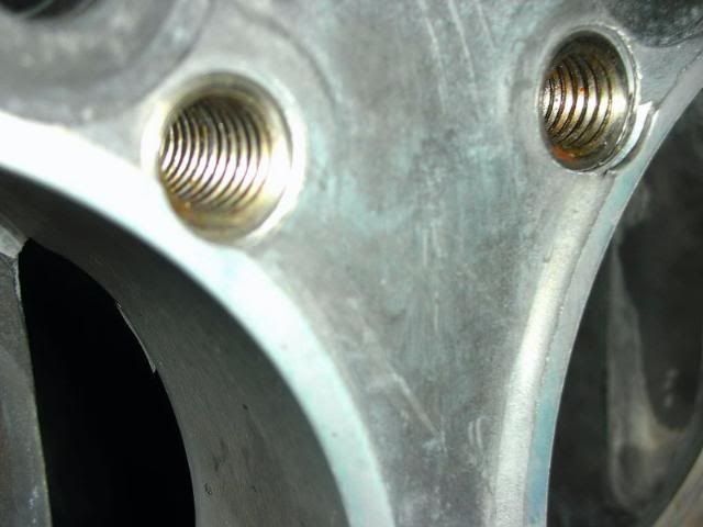

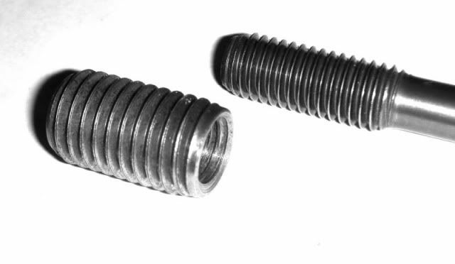

Tim, This is the way you want to go and I will try to say it in layman terms. This is the case I was going to use to build that 2.7 engine. The 2.7L engine '74-'77, in general, got a bad rap because of the EPA wanting all the smog crap on the motors in the mid-'70s. Porsche did a stupid thing to conform with these USA requirements by placing these "bread loaf" sized thermal reactors (like catalytic conv.) between the exhaust manifolds and extractor. These sat lengthwise next to where the lower head studs (exhaust studs)are screwed into the case. Probably P decided to place the harder studs in about late '77. Engines were dying on people between 70k- 90k miles. The obvious: heated up the engine case excessively; thus the "fine threads" drilled into the case by Porsche started pulling away.........
SO, the fix is to have a machine shop drill out those fine threads and drill larger COARSER threadings for STEEL inserts into the case. In otherwords, inserts with outer coarse threads with the factory fine thread inside them. SO now the head stud will NOT want to pull away because now it's pulling at steel instead of magnesium. And the outer is sunk into case with heavy meaty coarse threads. You don't need fancy expensive studs, just use the factory ones it was made for as long as they're staight and not over heated or cracked in anyway.
Hope this is helpful.... in time you'll catch on to things....ask 1000s of questions.... we have all been there.
Here are some photos of the steel threads before and after inserted to the case.
[IMG][/IMG][IMG][/IMG][IMG][/IMG]
