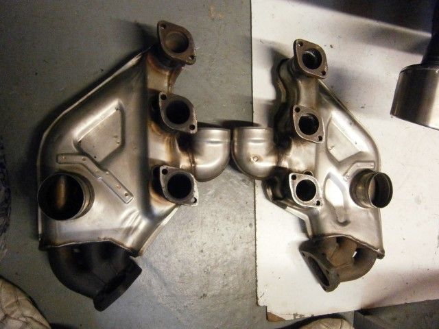

Exhaust diameters / 993 heat exchangers?
I'm having a bit of an exhaust re-think at the moment for a number of reasons one of them being the headers are sitting really low on one side and the car has some ground clearance issues. I am going to raise the rear ride height slightly but it still hangs pretty low.
I might also have a go at a new silencer to give me a few more options.
Final reason is that it's a pretty chilly place to be this time of year and I don't want a bit of cold to stop me using the car so may add a bit of simple heat back to the car. I must be getting soft in my old age!
The obvious headers / heat exchangers option is to use 993 ones with the flanges flipped and they have been proven to give very good power figures on some cars. I've borrowed a set to use as a template (cheers Jev) but having a measure the primary pipe internal dia is approx 1.5" and the outside diameter is approx 1.6".
My current headers while being cheap and cheerful with poor merge collectors (of a sort) have 1.75" internal dia and approx 2" outside diameter. Headers shown below and Magnaflow silencer shown in link.
964 Engine rebuild questions
This is quite a size step down which bothers me a bit and if it won't allow the engine to breath properly then maybe it's not the way forward. I always thought as a rule of thumb that 1.625" was the 'norm' for a 964 and maybe 1.75" for 3.8 or tuned cars which is why I'm a little surprised that 993's have 1.5" bores.
I realise that changing the exhaust will require a remap but am clearly reluctant to do the work and make the change if I end up losing power/torque.
Can anyone who knows anything about exhausts offer any advice?

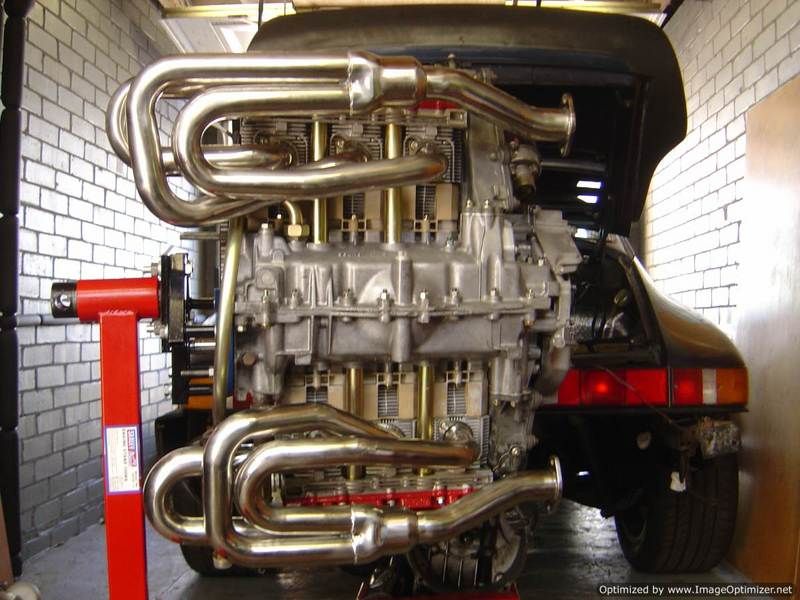

I've got a pic of a 993 cup set up (below) which is a similar setup as stock 993 but no heat required. I don't know what dia the pipes are and I find it quite interesting that people make quite a big deal about equal length headers when the 993 aren't even close.
I love the headers offered by s-car-go, washburn etc etc but my pockets really aren't that deep and although a lot of work has gone into them I do find them unnecessarily expensive, quality costs hey!
I guess one option is to hack mine up to try to reduce the depth they hang and add some burns collectors or buy some OBX or similar and chop them up.
The 993 heat exchangers seem a nice easy solution but I don't know if it will stifle the engine?

993 and 993RS has the same exhaust. The cup is also the same, but without the heater box around it.

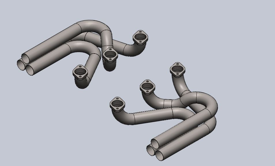

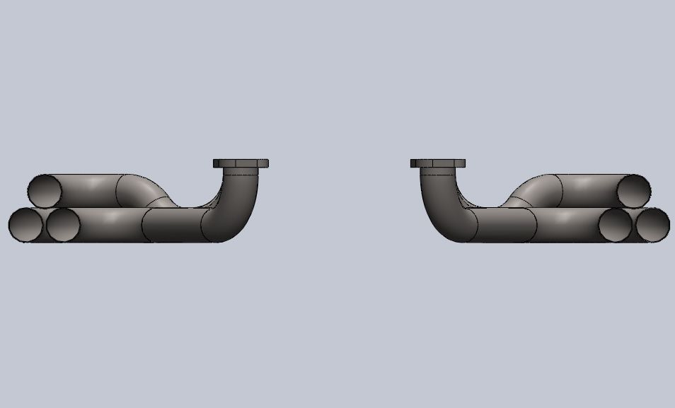

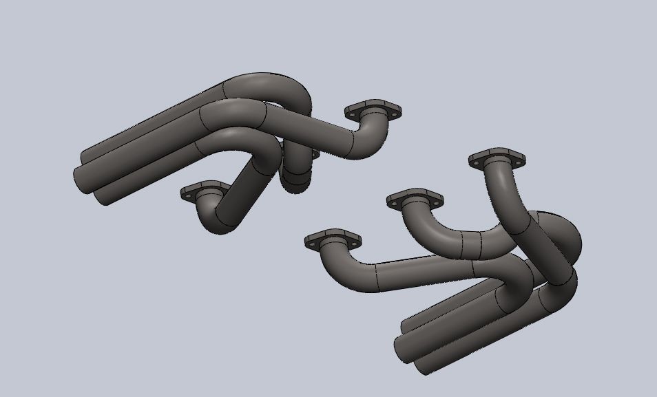

Header doodles
Hey John, mine was a 14" Magnaflow with 2.5" in/out too (see post #64). They work really well and cost peanuts as you say. Only difference with mine is instead of 993 h/e I went for a cheap set of 1/75" dia headers.
They are noisy but I made a pair of perforated inserts that fit in the tail pipe to quiet things down when needed.
I had a bit of spare time so was playing around with drawing some headers. They are reasonably equal length and made only using off the shelf bends. Bit rough and the 'S' bend on the middle pipes probably isn't ideal but wanted to keep it simple and stick to the 'off the shelf' philosophy. All of the bend rads are the same with 1.75" dia pipe and a 63.5mm centreline radius.
Don't really know where I'm going with this but maybe if they were tweaked to the right length with a pair of slip on merge collectors then maybe I could use the 993 h/e I have a s a jig to knock something up.
