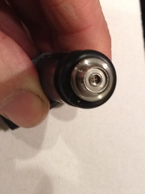

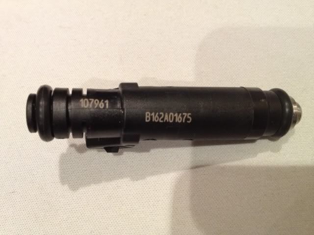

Don't know too much about the intricate specs, but the guy who's doing the mapping work for my EFI conversion using MBE management is a big fan of the latest Siemens Deka injectors...great spray pattern, easy to drive, can be driven to high duty cycles. Few pics attached below, and the p/n's on the body are: 107961 & B162A01675. Amongst other engines, IIRC, he's using these on race spec Suzuki Hayabusa engines (i.e. v high rpms) both n/a and supercharged (280fwhp, and upwards of 360fwhp respectively) fitted to hillclimb/sprint single seater Raynards/OMS/etc.

I agree, Siemens Deka's are great and I've used them on most of my cars plus many customer cars, mostly the 630cc @ 3bar variant or 880cc @ 3bar variant.
For example, 630cc versions on supercharged 993 Carrera (VEMS P'n'P ECU) and the same ones on my ~400 hp 931 race-engine.
