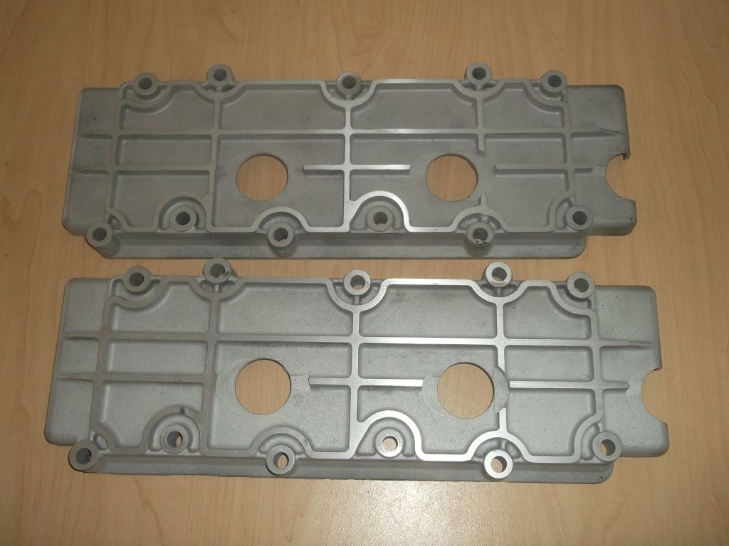

Search isn't helping me! How much do I need to remove from the turbo cover ribs on my 3.0 so I can remove them when its in the 914?

Just mill all the ribs down to the top of the bolt holes.
Still plenty strong enough and looks the best.

A pic so anyone searching this can see what I did.

Oh twin plug, nice
