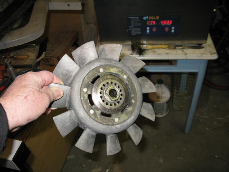

Jcslocum 02-18-2015 03:25 PM
It's still working like a dream and I'm continuing to clean parts...
Here is the fan done last night. #0 minutes and she was clean as a whistle!!

reddogmotrsprts 02-18-2015 04:02 PM
I have a pressure plate that was completely caked in decades of oily clutch disc material. I was able to dig long worms of oily solids out of it.
It barely fits in the 5 gallon model, laying horizontally. I gather that this is the kind of part that requires that you clean it for awhile, then flip it over to let the sludge drain out of the other side during a second bath.
I'm using Meyer's dish soap and water, but I can't recommend this combination as I don't think it has enough grease cutting power.
So far, I'm pretty pleased. I think the cleaner will work much better on simpler components such as brake calipers, hubs, valve covers, bearings, etc.
Jcslocum 02-18-2015 07:49 PM
For that kind of grease the best bet is water, dawn and some simple green. You need to really break down the grease.
The UT gets right into small holes (so I have read) and that is one main Bennie of the tech but not if the hole is plugged with grease. I can see that taking quite a bit longer
