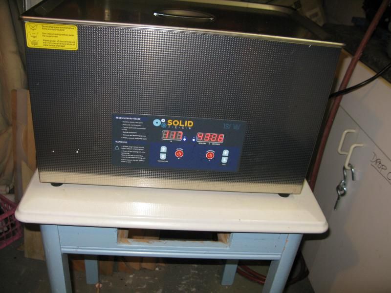

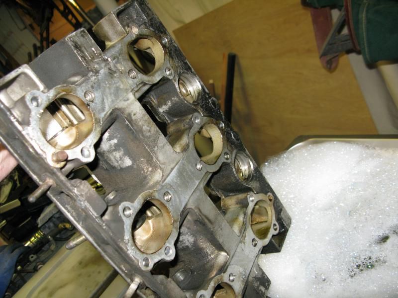

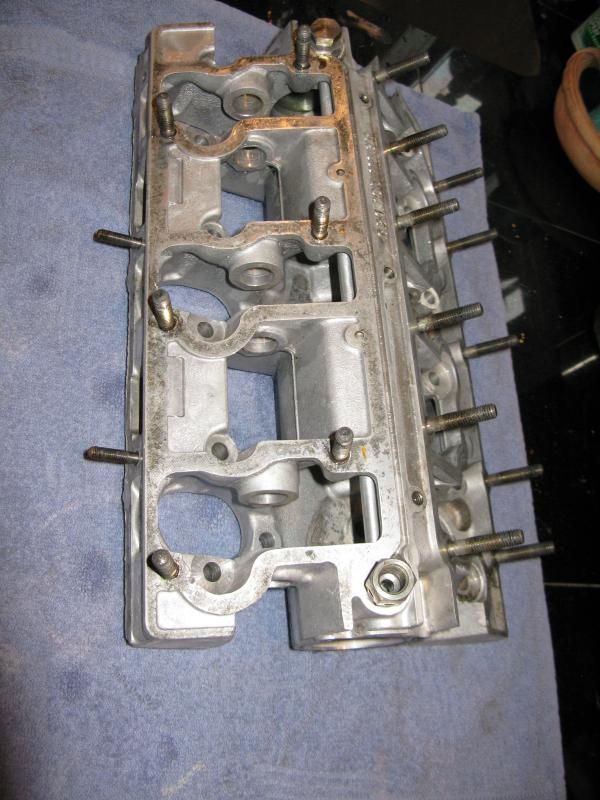

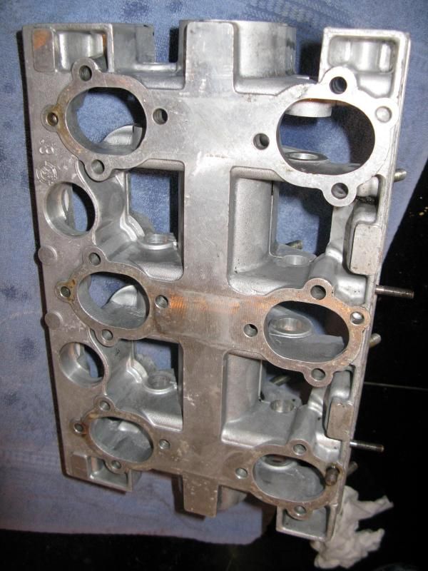

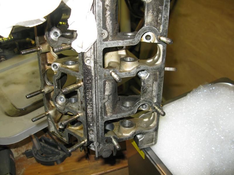

I try to add value here every once in a while. We are building a 3.4 911 motor here at home and it came out of a 100K mile car. I HATE scrubbing and scraping caked grease off of engine parts for a thousand reasons :-) I decided to buy an Ultrasonic Cleaner that would fit the largest part I would be taking off. On a 911 top end build, the cam towers are the largest parts to be cleaned and they usually have a shed load of grime and stuck gaskets. Lots of little nooks and crannies to dig 25 years of crap out of....
My first mix was tap water, Dawn dish soap and Simple Green. The tank holds about 5 gallons in it so I added a cup of Dawn and Quart of SG. It worked GREAT!! Today I did the cam towers since they have small oil passages that I didn't want to deposit some of the gunk into. Today I used water and Dawn. No SG in the mix. I can't express how well this worked!!! Just as good as the SG added and these parts are SPOTLESS now. No work on my part but the time worked to earn the $$ to buy them :-) This is an excellent parts cleaning investment and would recommend it to any hobbyist. The cost landed at my home was $375.00 and I figure I can always sell it once done if I fond no more really dirty greasy projects to get involved with. Yeah....right!! As a hobbyist, saving on this built quite literally many thousands, this is a small investment.

Heres a link
This vendor has many sizes so pick the one that fits yer parts best. No, not those parts, engine parts....
You must use a basket, and it comes with one. This is to keep the parts suspended in the solution while the magic is happening. I have been reading and there are many tricks to cleaning all different parts, little baskets with individual components, like carb parts, to ball jars with special cleaners in them with the parts inside and the UT cleaner only filled with water.
5 Gallon Solid Tech 20L Stainless Steel 400W Ultrasonic Cleaner Heater Basket | eBay
110 volt. Has a heating element that does a very good job of getting the cleaning juice up to 140 for added cleaning help.

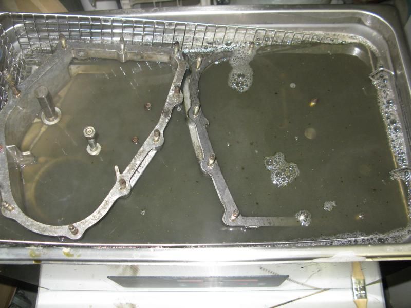

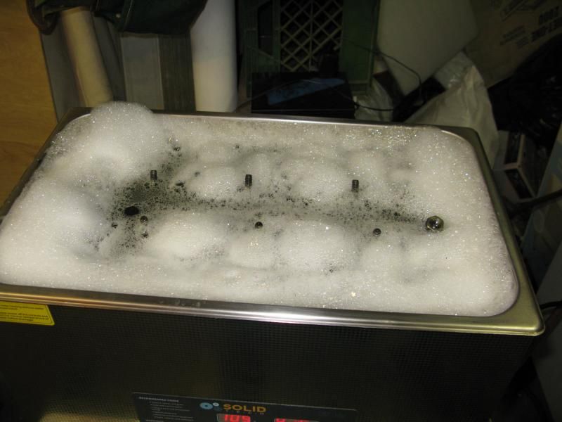

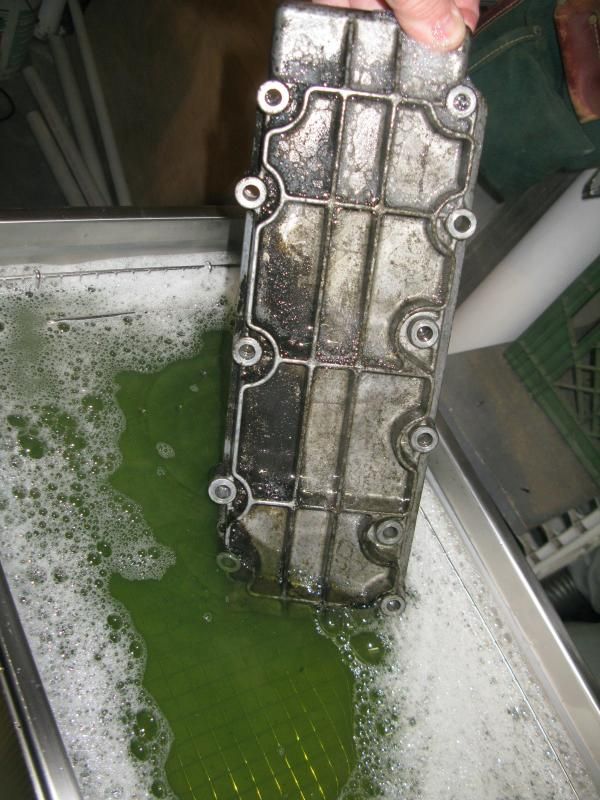

The cam towers were 30 min per side. 30 min does about 75% of the work, but a quick swish back and forth removes the settled gunge and then I flip them over. Have a beer, come back and take them out. Swish them around and then up to the kitchen sink for a quick rinse and dry. These are the parts where it really pays off. Looks at all the crap in and in there. Standing over a stinky wash tank with mineral spirits running and splashing around... Fugly.....
Some other parts run thru it.

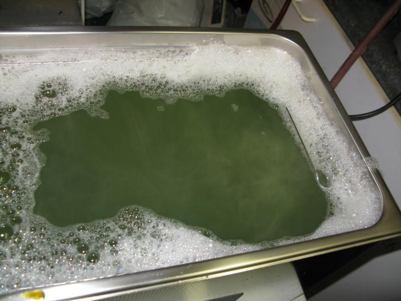

Lower valve cover into first cleaner batch: Tap Water, 1qt Simple Green and 1/2 cup Dawn Dish Detergent
Switched on, you can see the "fog" on the right as the magic is happening. This was immediate. Those scrubbing elves got busy!

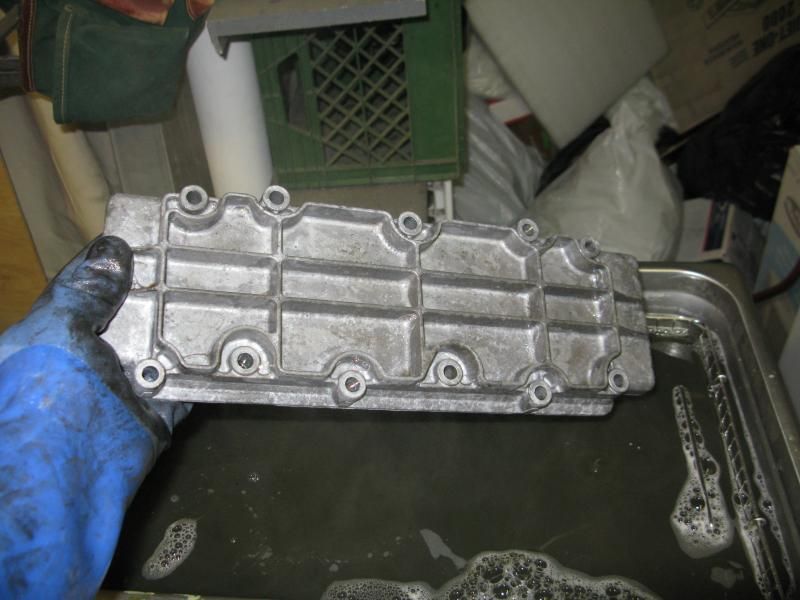

Valve cover coming out. 45 minutes in the bath. Didn't know how long it will take so just let it go. Look at to color of the water!!

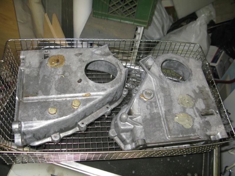

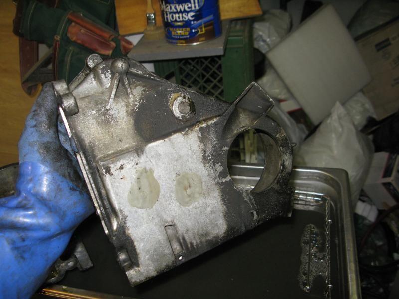

Cam chain housings going in. Water looks bad but still very effective.
Chain housing coming out. Filthy water
Chain housing done. It even loosened 90% of the epoxy on the backs of the housing that was leaking.
