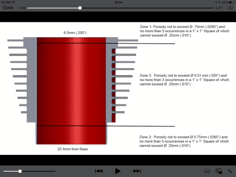

Cylinder inspection
None of the cylinders have any deep scratches or anything that would feel on the fingernail. All look and feel like they have no wear.
But there is some porosity/pitting on cylinders two, three and four. The sizes of the biggest single holes are about 1mmx0.5mm.
I wonder if these have been there from the beginning or have they been caused by some bad maintenance during the life of the engine. Too long service intervals? or very long period with no use?
Cylinder 2: One are of concern at 12:30, 22mm from the top (1mm scale on the picture)
Cylinder 3: One are of concern at 10:00, 81mm from the top
Cylinder 4: One are of concern at 12:00, 34mm from the top and one other at 10:30, 25mm from the top.
Question 3: I wonder what actions should I take with these?
1) Reuse them as such. The holes are very small and they don’t currently cause any problems. But the worry is that if they would grow bigger.
2) Replace the three with used used cylinders/pistons.
3) Re-plate the three cylinder with Nikasil. Millennium Technologies would do re-plating but that would be costly option to ship them back and forth from Finland. Does anyone know if there is a company doing that in Europe?
From the Millenium-tech web page I found this spec for the porosity.
Measurement data shows that all of the cylinders are still within specs.
Ovality is also within specs, only point to note is that the middle cylinders 2 and 5 have the ovality in different direction that the others. Maybe the thermal load has caused this.
Question 4: Have anyone seen this before?

I'd be shopping for new cylinders. It's a 930, there is no reason to skimp. At the very least send them to US Chrome or Millennium, have them re-nikasiled.
