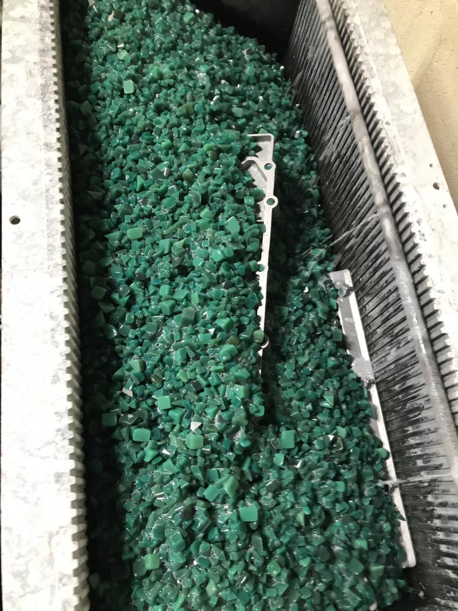

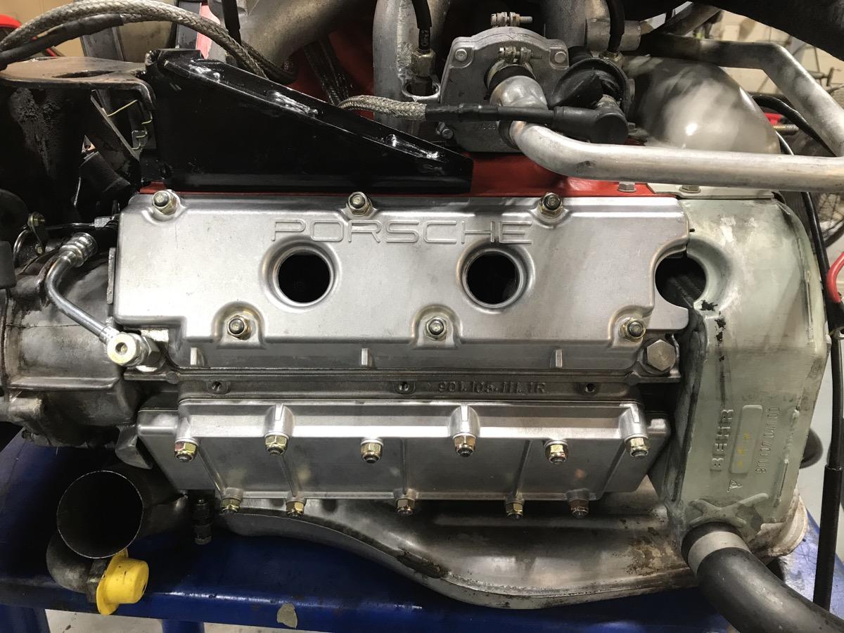

Hi boys..if i can give an advice i would use this king of cleaning procedure.It is tumbling.
Find somebody near who has this king of machines.Or have a look here.
https://www.candmtopline.com/finishing-tanks/
The part just comes out like new.My friend in Al has the 300HD and parts look like this
