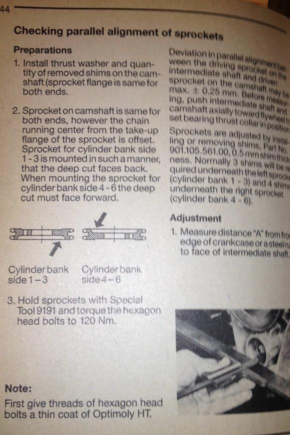

I have a 1984 3.3 Turbo engine which has a pretty significant oil leak coming from behind the right chain housing. I believed the issue was a leaking gasket or o-ring from the cam/chain housing. upon investigation, I found that there was a significant crack all around the cam thrust cover (930.105.196.00). I will be replacing this cover, the O-ring and gasket. My question however is root cause. The only thing I can think of is if there is excessive play in cam that caused the housing failure. Has anyone else encountered this issue? Is there anything else I should be looking for? Bellow is a shot of the crack.

Make sure the cam sprocket is on the right way too.

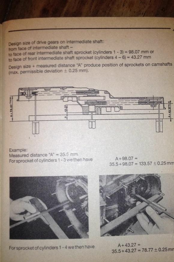

hi ..is there any history we do not know about? Like the engine has been worked on recently?
I would definitively suggest to check parallel alignment of timing chain sprockets...
Ivan

Check your sprocket wear. It may indicate there is an incorrect number of shims under the cam drive sprocket.
There shouldn't be any real
Thrust on the cam. But maybe, there was too many shims and the chain exerted a force pushing the cam into the head
The crack looks pretty big. Someone use a big hammer to get the woodruff key out?!

as i said above you have to do this...either you or someone had to switch left shims to right and vise versa ..what is the history?
Ivan
