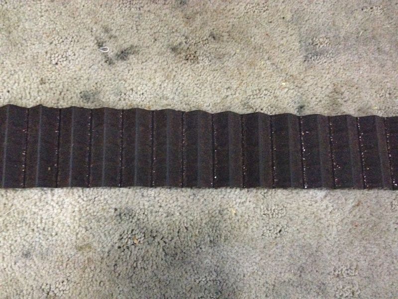

After about a month I noticed a slight knock when I backed off sometimes but not every time. 4 knocks at most when you backed off the throttle say over 3000rpm.
I have heard a lot of big end knocks in my time but this was more like a rattle than knock and no noise whatsoever at idle.
I was leaning toward waste gate rattle but all the posts of waste gate rattle on youtube sounded tinnier.
As a dealer hater I took it to a BMW engine guru who revved it a few times and listened at idle and said " I can't tell what it is, it sounds like its on the right hand side where the turbo is but I haven't had any N55 with problems like this so far"
Ok I give in it's off to the dealer the car was sold at and had the full service record with.
They were good the service manager said "We just so happen to have a master service technician from Germany here with us so I'll get him to have a look"
I took him around the block and there was no way I could get the car to make the noise.
He said to pull over and just increased the revs to 1500rpm and there she was , a text book rod knock and constant.
He told me they were pulling down another N55 engine in the workshop and offered to show me the damage a spun bearing can do.
Every machined bearing surface was destroyed, crank, cams all scored. He told me the bill for this guy was between 26 and $30,000 aud.
I can remember actually feeling physically sick.
I think Rheinhold the master technician felt sorry for me because he said if I were you I would get the car home and diagnose it yourself by taking out the oil filter and cutting the ends off. Fan it out and look for copper fairy dust were his words. He added ' If Tinkerbell has been you will see your answer.
He also told me to look for a low klm write off engine and replace mine.
