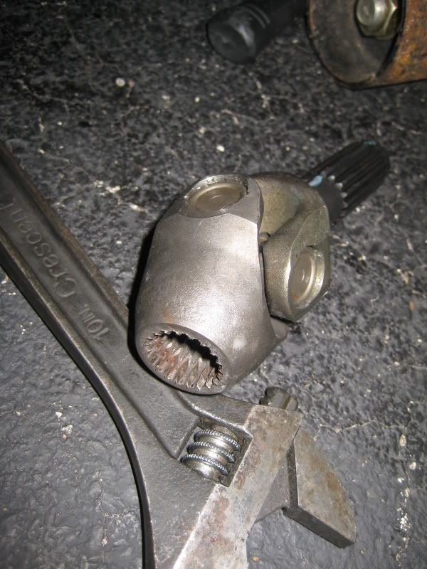

So if I get rolling in any gear and pull in the clutch lever to coast at speed, I get a clicking. Not a high-pitched click like a playing hard hitting spokes, but like the lower sound that a large hex bolt would make rolling around in a cast bowl.
As it's speed-dependent, it seems like it would make sense that would be on the clutch or afterwards in the drivetrain. Could the rivets that hold in the clutch material just be shot and so the material is clattering around? The sound does seem to be coming from the transmission area, but has that hollow sound of possibly being in the bellhousing or the hollow swingarm. I can feel a slight vibration in the throttle that accompanies the click.
Lately, as I pull the clutch in at neutral with the bike running, I get more clatters than I used to.
The bike shifts fine and the clutch isn't slipping at all. It hooks up the same as it used to, but there is a slight jerk that seems to have grown, which I used to attribute to the slack in the fuel line. Could that be the clutch slipping and catching? With 93K and the stock clutch, I wouldn't be surprised, but I would have expected the clutch to start slipping before this happening.
Anyone got a clue on this? Is there a bolt that may have come loose that is working it's way out and clicking on the housing as the drivetrain turns? I know I can just dive into it, but I was really planning on doing other things this weekend.

Dan's thoughts made me leary. I didn't want to dive deep into the S without a proper shop, lift, stand, or anything else. But if I'm going to head out to the Falling Leaf Rally, I'd at least like to know what my odds are of a complete round trip.
March: Swapped pivot bearings, misaligned the u-joints upon reassembly
June: Realigned the shaft. Vibration reduction was good, but over the summer, worsened.
September: Clutch-noise issue that started this thread.

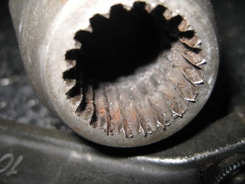

So I dropped the final drive tonight. The inboard pivot pin gave me clue#1. It had a circular cut to it at an acute angle, as if the driveshaft were milling it away. The outboard pin was in good shape. Pivot bearings intact and tight -- no crushed needle bearings, etc. that could cause the vibration.
Small metal shavings from the pin were strewn about the housing, some mixed with oil from the leaking input seal on the final drive. The boot leaked a good 10cc's of gear oil. Mmmmmmm. . .
The rear driveshaft u-joint, which had milled away a portion of the pivot pin appeared solid and amazingly undamaged. Minus, of course, the very faint appearance of the interference which had been happening. I was wondering where the slop was that was allowing this play that caused metal-to-metal contact.
I pulled the intermediate splined shaft out. Things looked good. Male and femal splines were good. Then I pulled the intermediate shaft off of the final drive's shaft.
That's when it all became clear.
When I realigned the driveshaft after misaligning it the first time, I didn't check the intermediate shaft's female spline at the time. I'm guessing the problem had already begun to propagate from the excess vibration involved in riding the bike for a month with misalignment and negligant (honestly purely lazy) attention to the need to fix the misalignment.
So I didn't catch the fact that 3 months ago that these splines were already damaged and continuing to ride on them were only making them worse.
They got so bad that there was slop in the drivetrain. The clattering was the splined shafts knocking back and forth as the wheel turned going down the road. Without a load on the drivetrain to make it accelerate or decelerate, the driveshaft was getting knocked forward via the inertia of the wheel, slowing, then getting knocked, slowing, and getting knocked. This was the clattering noise I was hearing.
The good news: Final Drive spline is solid and undamaged, despite the ugliness of the contacting female spline. I have spares and the bike has been tested and is smoother than it was since 70K. I pull in the clutch and there's no noise to be heard! I'll be at Falling leaf!

Was that rear u-joint completely engaged on the FD shaft? The wear does not look that deep on the u-joint.
