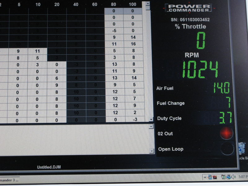

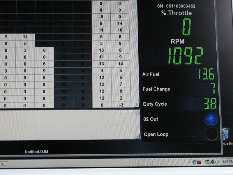

Power Commander III USB, control panel question
I have a Power Commander III USB, from 2004. Anyone know what the 'O2 Out' indicator tells you on the control panel?.

It's my understanding that the grey area is controlled by the O2 sensor while the while one is controlled by the map. The O2 out means that the system defaults to the map not the sensor.

Blue is rich, Red is lean(compared to your AFR setting). O2 Out should toggle quite frequently between the 2.

Thanks, at idle the A/F is around 13.6 and the indicator is blue then the indicator goes red and the A/F goes up at least a half point into the 14s. Ever time it goes red the idle get lumpy. Have never seen it go red if the RPMs are above 1500.

The gray cells by Throttle Position and RPM are controlled by the OEM ECU Mapping. They can not be modified.
The tune-able white cells can modify the OEM ECU Mapping output to the injectors +/-.
The software you have is outdated.
The fields - 02 Out and Open Loop have been removed as it caused too much confusion with the owners and dyno tuners. Useless and very vague info of the bells and whistles category.
Upgrade your software for the Power Commander Control Panel:
PC III USB Control Center Software 3.2.1 Release Date 05/13/2010
Depending on your PC III build date you might have more fields that are not grey that you can modify with the 3.2.1 version.
Note: Please understand that some of the PC maps in the PC database have extreme variants in the fueling values between the left and right cylinder (Cylinder Trims). I can not explain these extreme variants!
In tuning for max power, you must tune both cylinder's fueling values to eliminate or offset normal fuel delivery varients. If it results in extreme variants look for an organic issue like bad spark plugs, coil, out of sync throttle bodies or dysfunctional injectors.
