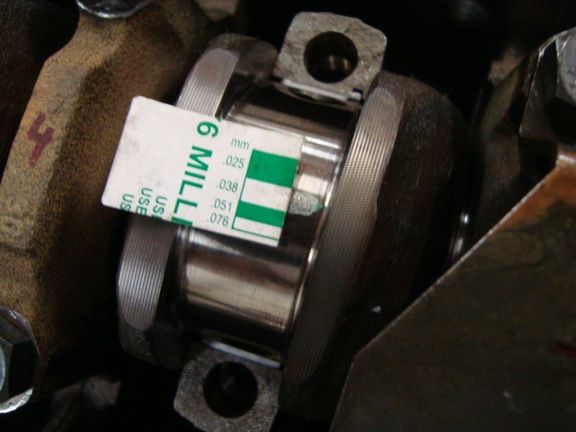

.........................With using a simple dial caliper I measured the failed #3 and compared it to the good #4, the difference as best I could determine was less than .001." Keep in mind this is a not very accurate method of determination, but I decided to install new bearings and see what happens as the new bearings only cost me $150......................]

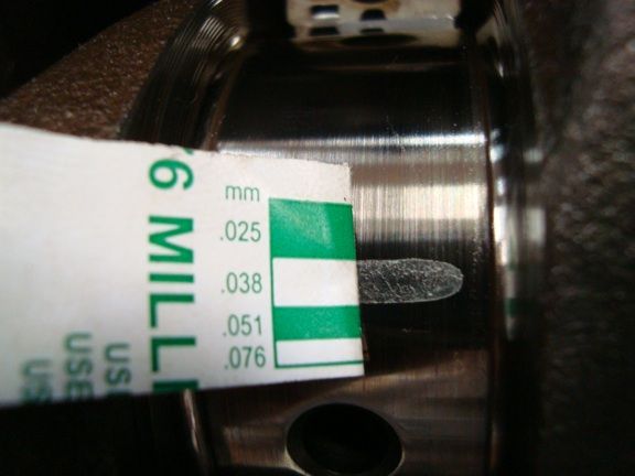

Did you use plasti-gauge, when you put it together the first time, I am curious what that showed.

Richard, no I did not plastigauge the original bearing. Between the working condition of the rod still in the block with it dangling above my head (still in the car too) and oil still on the components I did not think the plastigauge would provide accurate results. And speaking of time, I can have this engine on the ground in a couple of hours and frankly many of the BMW engines for that matter. The early 2000s E46 chassis I can do an engine start to finish including switching all components in a day. Not bragging just saying while there are now different ways of doing things they are necessarily harder. Now if you wanna swap a 2012 750i Turbo V8, you better give yourself a couple of days, haha, but I know I'm not telling you anything you don't already know ;)

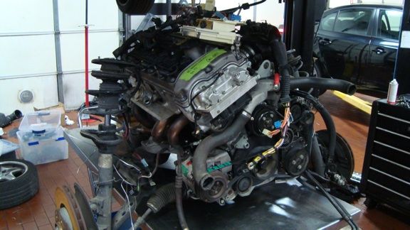

Pics just posted for entertainment purposes. About $5-7 thousands worth.

TM1100s, what is the story on your engine? Track days, redline, just curious.
tm1100s 08-09-2013 08:43 AM
Belongs to a local doctor who raced it, in STU class I think.

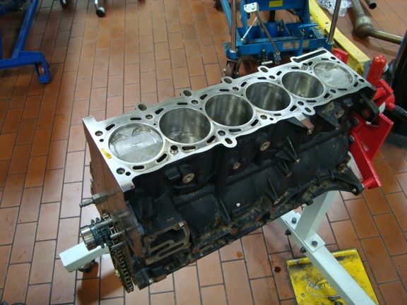

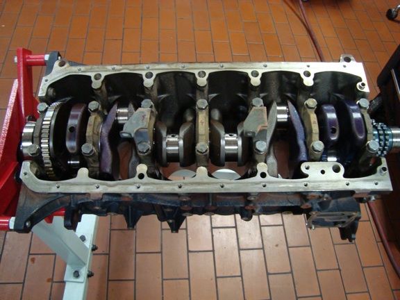

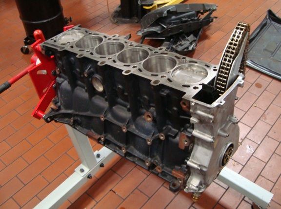

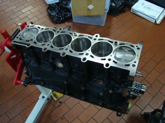

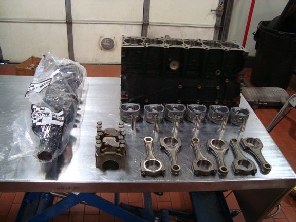

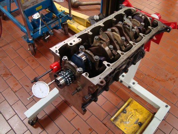

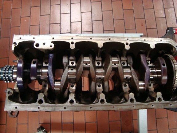

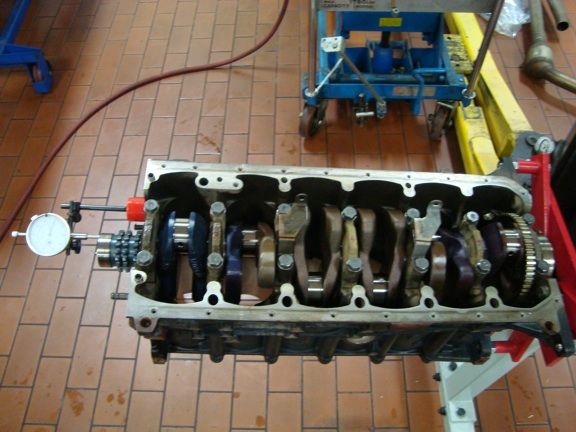

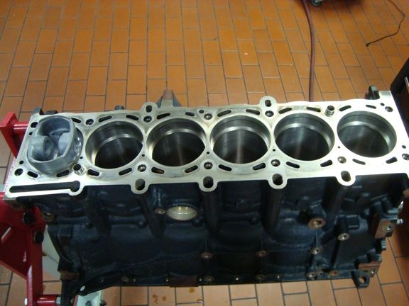

Everything is back from the machine shop. The cylinder head got a full rebuild including valve job and seals, resurface, pressure checked for leaks and the valve springs were checked for weakness. The block got decked and a light hone. The crank was able to be polished and the bad rod journal cleaned up at 0.0001" under spec of the other journals. The pistons were checked for roundness and are good to go so we will reuse them.

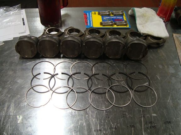

On the subject of rods, I needed 1 rod. The rod cap is separated from the rod be "fracture" method, meaning the cap is literally broken, this creates a more positive engagement ensuring the big end stays perfectly in alignment on reassembly. Unfortunately that means the rod cannot be resized, so the spun bearing rod is essentially now a paper weight. BMW specs these rods in sets matched by weight and will not sell just one rod seperately. So there are a couple of options: 1 used rod, A full BMW set or an aftermarket set. A New set of rods is well over $2000 and is not in the budget, Good aftermarket rods are well over $1000. So that leaves us with a used rod. Unfortunately It is extremely rare to find a good 6 rod set, usually you can find sets of 6 with 1 being bad. Also for this engine there are two rod designs and they are not interchangeable. I decided to buy a set of 6 with 1 bad, thinking I would take the best 6 rods and then have them balanced to eachother. While in the process of doing this I located a good full set of the new design, and purchased those as well. So, now I have my original 6 (1 bad), an early design set of 6 (1 bad) and a set of new design (all good). ARP offers replacement rod bolts for the new style rods so thats what we ended up with, new style rods with ARP rod bolts.
http://img.photobucket.com/albums/v8...lockParts1.jpg
Checking Main clearances
http://img.photobucket.com/albums/v8...ankInBlock.jpg
http://img.photobucket.com/albums/v8...rance2-1-1.jpg
http://img.photobucket.com/albums/v8...Clearances.jpg
End Play
http://img.photobucket.com/albums/v8...AsEndPlay2.jpg
http://img.photobucket.com/albums/v8.../AsEndPlay.jpg
Rings
http://img.photobucket.com/albums/v8...RingGap1-1.jpg

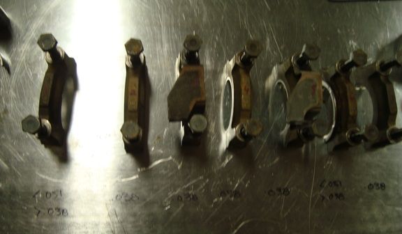

Rods
http://img.photobucket.com/albums/v8...dClearance.jpg
http://img.photobucket.com/albums/v8...Clearance2.jpg

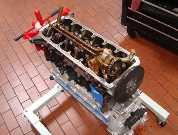

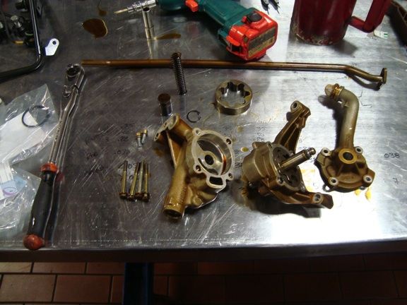

Disassembly and Cleaning Oil Pump
http://img.photobucket.com/albums/v8...lPumpApart.jpg

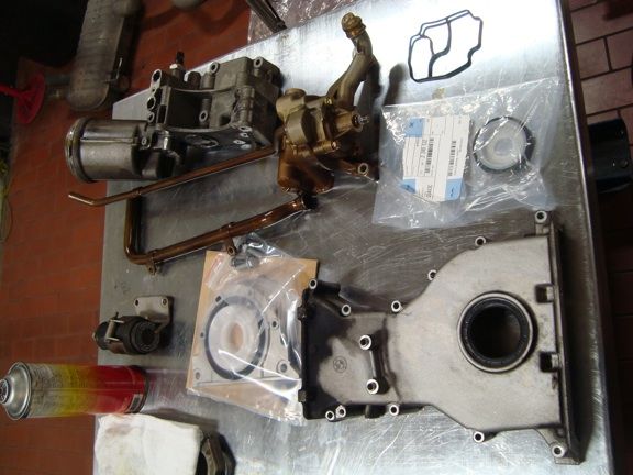

Oil Filter Housing, Timing cover, Oil Pump, Frt and Rear crank seals
http://img.photobucket.com/albums/v8...ampTCampOP.jpg
Starting Assembly, Crank in.
http://img.photobucket.com/albums/v8...nkInBlock3.jpg
Rods and Pistons
http://img.photobucket.com/albums/v8...ampPistons.jpg
Oil Pump on
http://img.photobucket.com/albums/v8...pInstalled.jpg

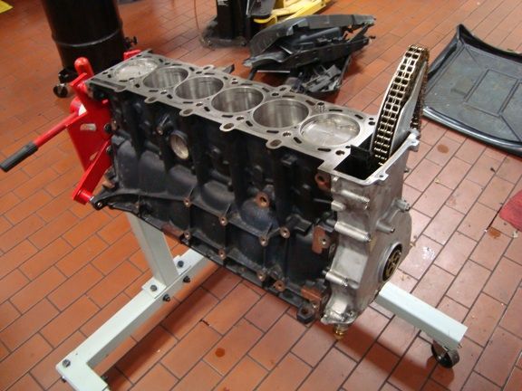

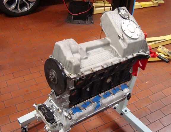

Bigred455 08-18-2013 10:22 PM
Shortblock complete
http://img.photobucket.com/albums/v8...rtblock1-1.jpg
http://img.photobucket.com/albums/v8...rtblock2-1.jpg
Timing Chain, Chain Guides and Frt cover
http://img.photobucket.com/albums/v8...kWithChain.jpg

George, what is the teethed ring on the aft end of the crank...is it part of the crank position indicator? Thanks for the updates....cool stuff.
Lane
wswartzwel 08-19-2013 06:19 AM
Glad you had the crank fixed... in an earlier post you said it looked good after having a bearing welded to it.
Bigred455 08-19-2013 06:57 AM
Lane, yes that is the reluctor wheel for the crank sensor.
Bill, sorry if I mistyped earlier, the bearing was not actually welded to either part. It had spun and left the crank discolored but not scored enough to catch your fingernail. The other problem is that sometimes the extra clearance will allow the rod to hammer the crank, causing it to bend. Luckily most of my discoloration was bearing material transfered to the surface and the crank was still true and straight.

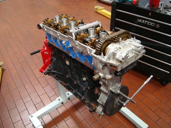

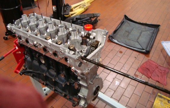

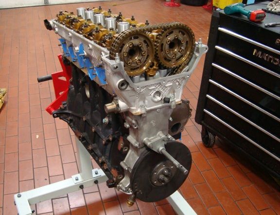

Timing chain, guides and cover installed
http://img.photobucket.com/albums/v8...nInstalled.jpg

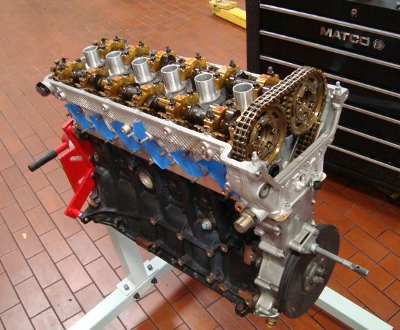

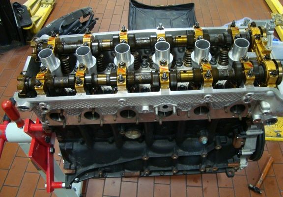

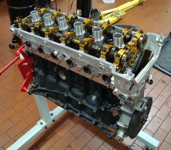

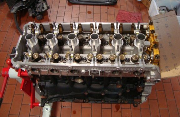

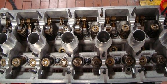

The Cylinder head is now on and onto assembly of Valve train. First the Rocker arms are mounted to a shaft one for the Intake and one for the Exhaust.
http://img.photobucket.com/albums/v8...ockerShaft.jpg
http://img.photobucket.com/albums/v8...RockerArms.jpg
The rocker shafts slide in through the front of the engine.

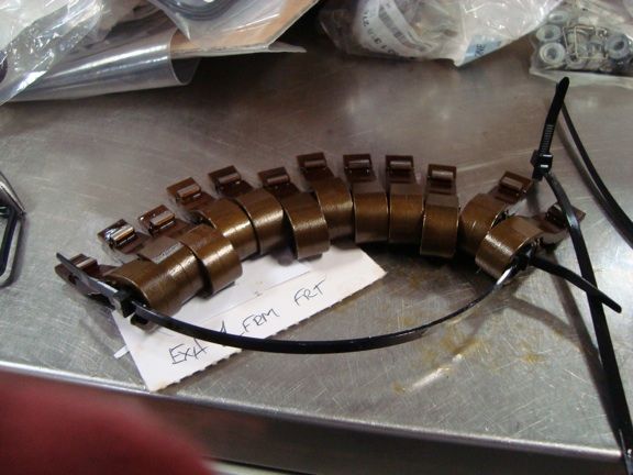

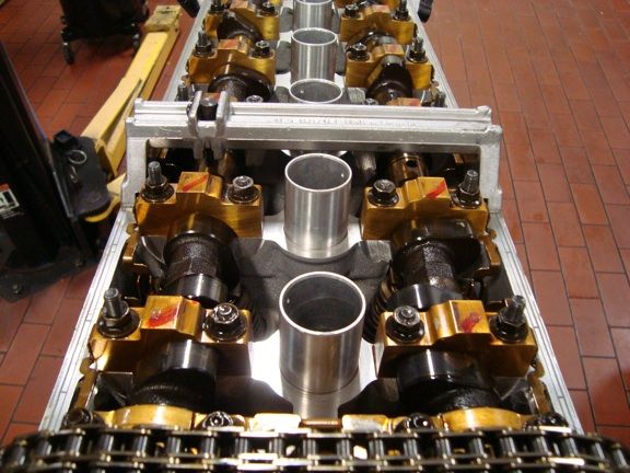

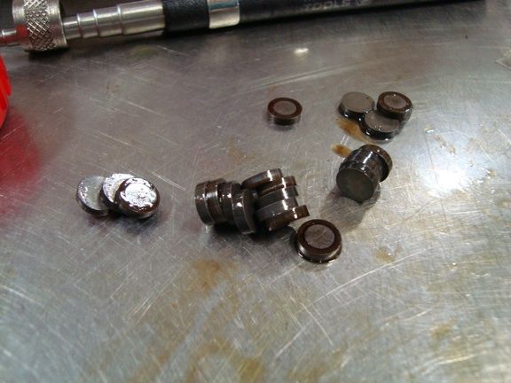

With the rockers on the shafts Now we will install the valve shims. On this engine the valve lash is set with shims of varying thicknesses in 0.04mm increments. Checking and adjusting the valve lash is part of this engines Insp 1 and 2 services (roughly every 25-30k). I recorded the shims on disassembly with the thought that if I reinstalled them they would be close baseline for adjustment. This worked pretty well and most were close to the original shim.
http://img.photobucket.com/albums/v8...ValveShims.jpg
Then the Camshafts go in.
http://img.photobucket.com/albums/v8...sInstalled.jpg
http://img.photobucket.com/albums/v8...Installed2.jpg
Bigred455 12-15-2013 07:42 AM
Then the Cam gears

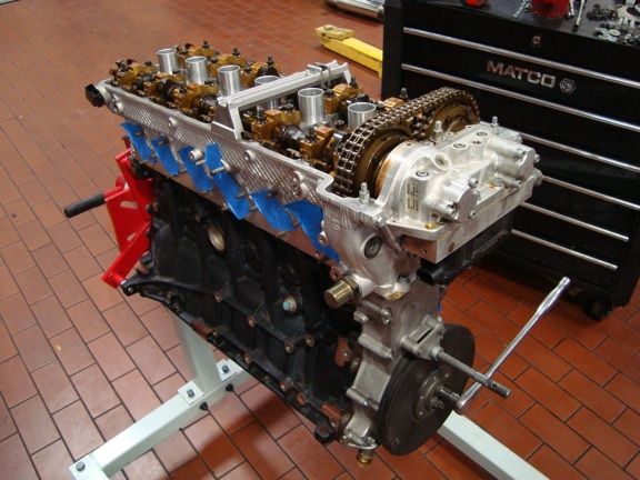

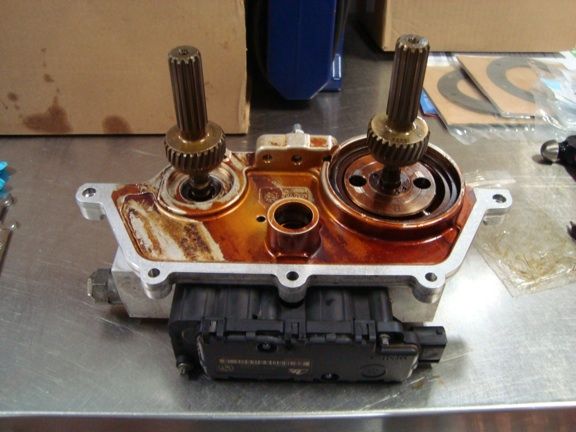

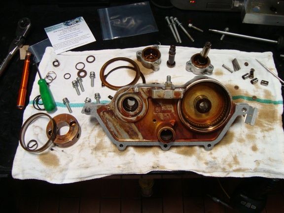

Rebuilding the Vanos Unit. Vanos is BMW's variable valve timing moniker. There is a company that makes a seal kit, so i disassembled to ensure it was free of metal debris and seals were not damaged. There is a filter at the oil inlet area and it seemed to prevent any debris from entering the Vanos unit.
http://img.photobucket.com/albums/v8...nosRebuild.jpg
http://img.photobucket.com/albums/v8...VanosReady.jpg
Vanos unit Installed and setting the cam timing. You can see the pin in the crankshaft balancer that sets the crank at TDCC for cyl#1. And then on the camshafts there is a bridge looking tool that has pins that drop into the camshafts that lock them in this position as well.
http://img.photobucket.com/albums/v8...ney/Timing.jpg
http://img.photobucket.com/albums/v8...ey/Timing2.jpg

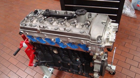

Valve Cover installed
http://img.photobucket.com/albums/v8...rInstalled.jpg

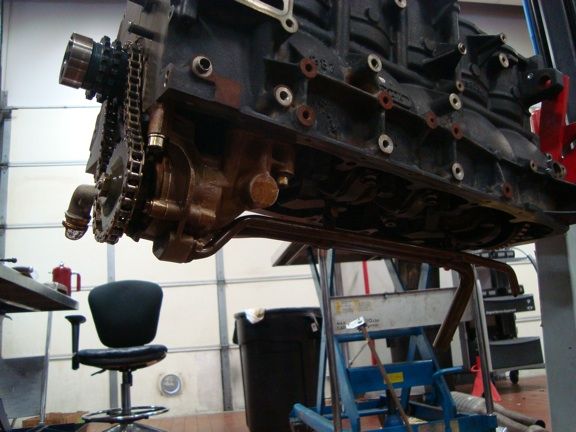

And Installing the Oil Pan, always install the pan last if possible, just in case you drop something down the oil drain back passages or timing chain area. Luckily I've never done that. hahaha
http://img.photobucket.com/albums/v8...yForOilPan.jpg

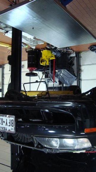

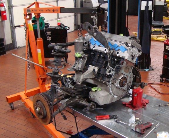

Car is back in the shop and on the lift
http://img.photobucket.com/albums/v8...ForInstall.jpg
Subframe back out of the car and Engine installed on it.
http://img.photobucket.com/albums/v8...OnSubframe.jpg
Going back up!
http://img.photobucket.com/albums/v8...neComplete.jpg
