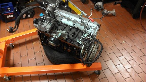

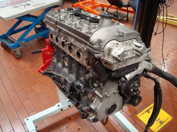

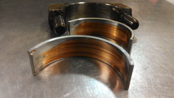

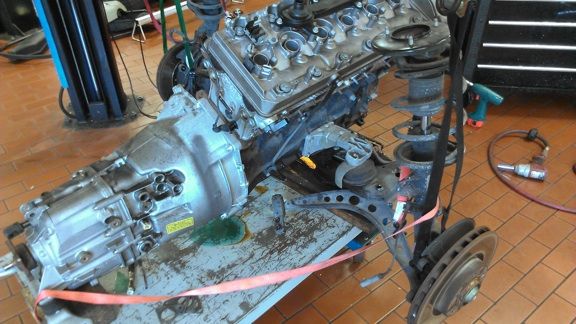

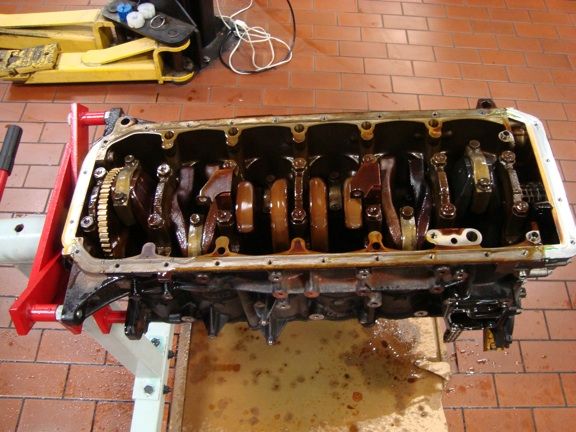

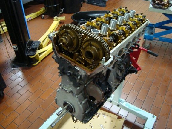

As some of you know I am a mechanic by trade and as a hobby I like to buy broken cars, fix, drive for awhile, sell and repeat. This is one of my latest projects, a 2002 BMW M-Z3 with a lower end engine knock, these engines (S54) are known for having rod bearing issues. When I first got this thing I pulled the engine apart and inspected. Once apart I found the #3 rod bearing spun, but the crank was found to be in great shape and the rod looked not half bad. When a rod bearing spins it will actually cause the big end of the rod to oval, increasing the veritcal (with the small end pointing up) diameter while decreasing the horizontal diameter. If the big end is not resized or made round again the new bearing will surely fail. So with this in mind I did my best to measure the horizontal diameter and compare it to one of the other rods. This is a particularly difficult task as the rods are still installed in the engine which is still installed in the car. Not to mention the rods are split at the big end by the "fracture" method meaning there is not a straight line seperating the rod from the cap. With using a simple dial caliper I measured the failed #3 and compared it to the good #4, the difference as best I could determine was less than .001." Keep in mind this is a not very accurate method of determination, but I decided to install new bearings and see what happens as the new bearings only cost me $150.
The plan was to thoroughly torture test the engine and then before I went to sell it I would I pull the pan back off and check the bearing condition. This lasted for 1500 miles before the engine started to knock again. At this point I decided to do it properly. This includes a rebuild consisting of all bearings, rings and gaskets along with another set of rods and lastly the necessary machine work to make the engine as good as new. I decided to document the engine rebuild for the future owner. I thought being gearheads this project would be of interest to yall here. The engine is running as of yesterday and I am starting the arduous BMW recommended 1200 mile breakin consisting of 1200 miles below 5500rpm and 109mph.
To start off here is the engine removal and tear down to long block status.
Failed #3 Bearing

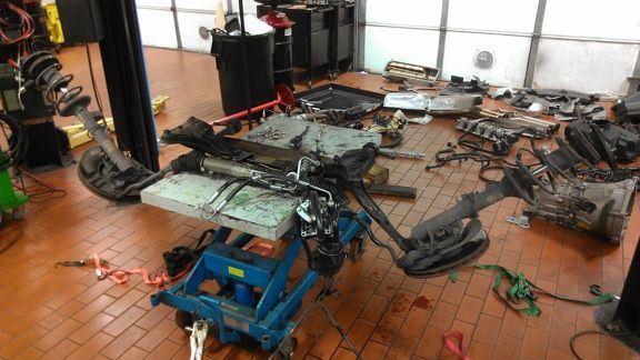

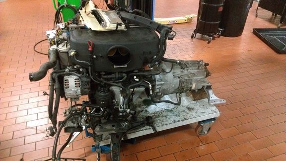

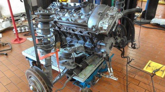

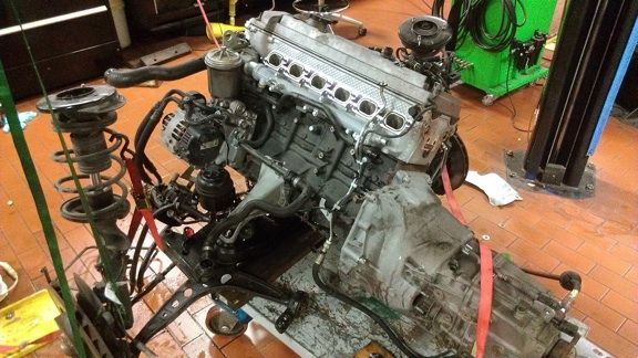

For BMW engines I like to remove the engine and transmission with the front suspension as unit. In doing so the exhaust, driveshaft, fan, air intake and wiring is removed. Here is the engine just before lowering.
Dropping the engine is made quite simple with the use of a lift and a table, our table has wheels to maneuver and can be raised and lowered.
-George Hill

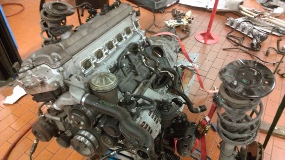

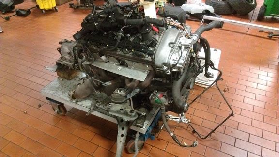

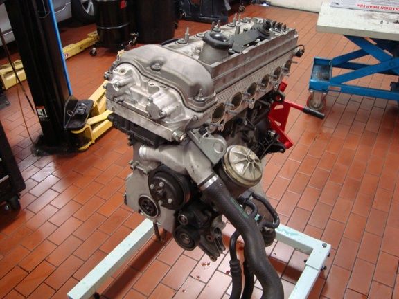

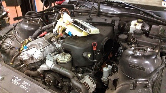

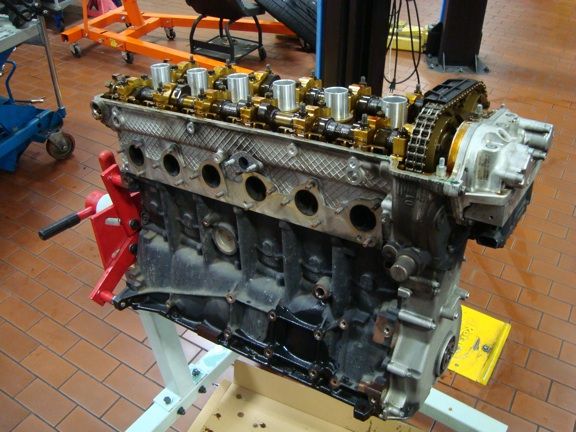

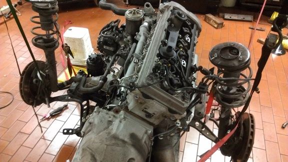

Next the engine accessories are removed to allow the long block to be removed from the subframe and installed on the engine stand.
Here you can see the exhaust manifolds are gone along with some of the wiring and coils
Next, the intake, throttle bodies and electronics are gone.

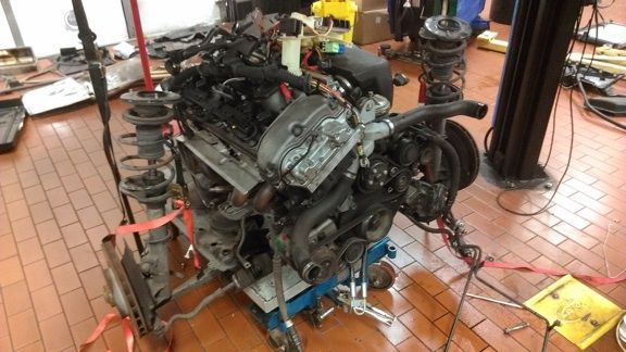

I had to install the suspension back into the car to be able to move it, so while pressed for time I had to ditch the engine off the suspension and get that stuffed back in the car. Future resting place for the engine until I can get it on the engine stand.
And finally the empty suspension getting ready to be uploaded back into the car.

Wow, that's huge. I am and always will be a gear head, even though I am stuck wearing a tie most of the time, I still like wrenching. One question, why did they have a tendency to spin bearings? My biggest job in many years was in may this year, a montronic sleeve on my 530i. It was the first big maintenance job on this car, not bad for 220,000 miles. But it was not fun using jack stands. I have never owned a car that I enjoy driving as much as this car, that does everything pretty good.

Yes, the early S54's (and really all years) are affected by potential bearing failure. The original cause was blamed on faulty bearings, but I have seen newer engines with them spun too. This was a severe enough problem that BMW had two service actions for replacement, but the Z3's were to be exempt due to their slightly lower hp rating and lower RPM redline, but clearly that didn't stop mine from spinning, haha. I don't know the real cause but I'd expect the cause more to be with rod journal size, Max RPM and oil as this things spin 8k RPM and uses a 10w60 oil.

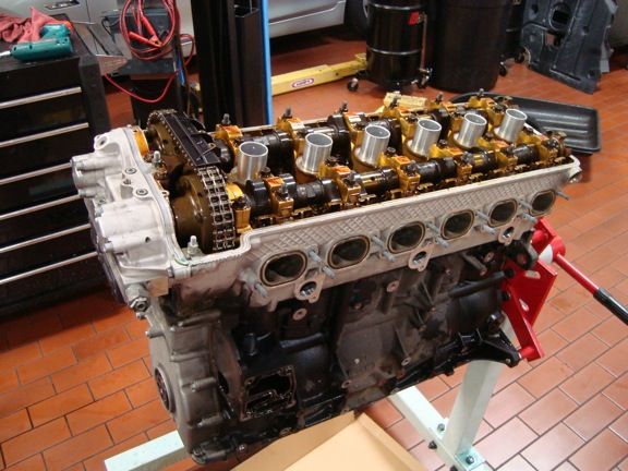

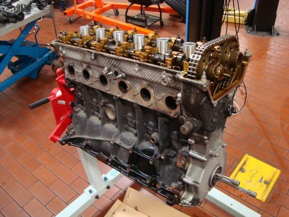

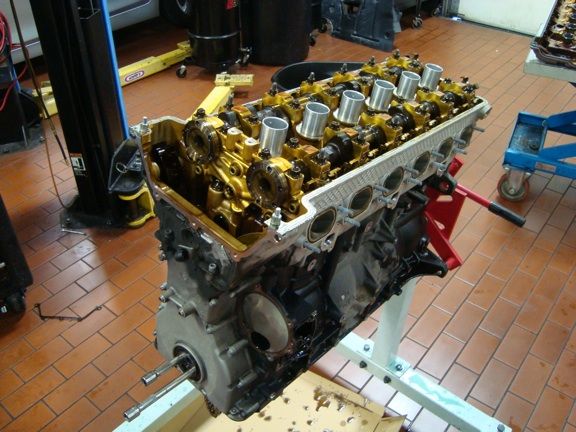

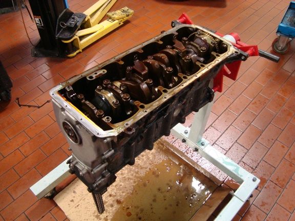

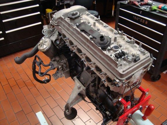

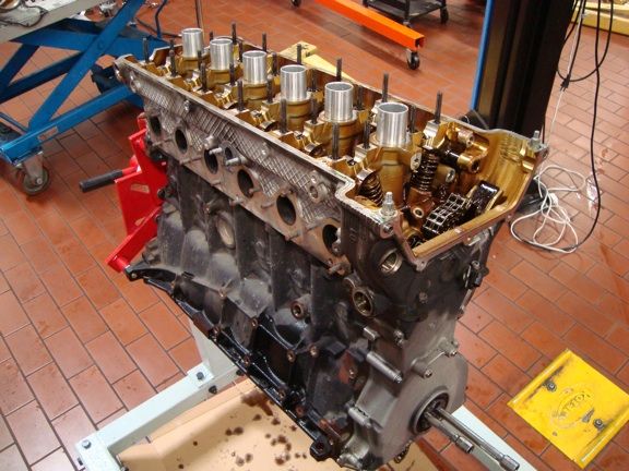

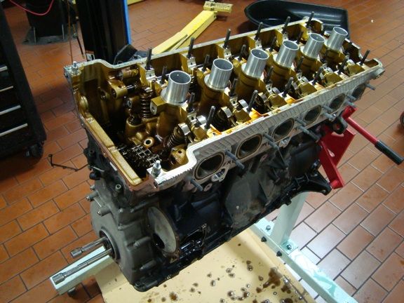

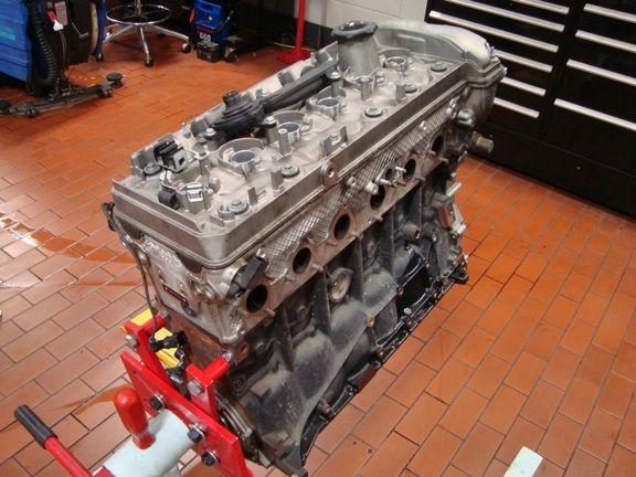

With The engine on the stand the fun begins
Next The Valve Cover comes off
-George Hill
'12 GSA, '00 Mandarin S, '09 HP2S, '99 Naked S, '03 Yam YZ250F, '91 Suz Dr350, '01 Yellow/Black S - Dead
Old 08-05-2013, 07:52 PM
Location: Austin, Tx
Posts: 1,088
Send a message via AIM to Bigred455

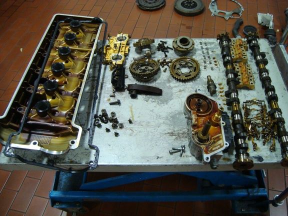

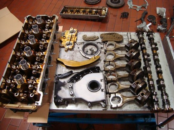

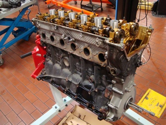

Then the variable camshaft timing unit (Vanos)
Then the gears and timing chain
Then the camshafts
Valvetrain laid out on the table
-George Hill

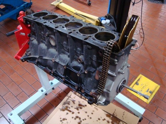

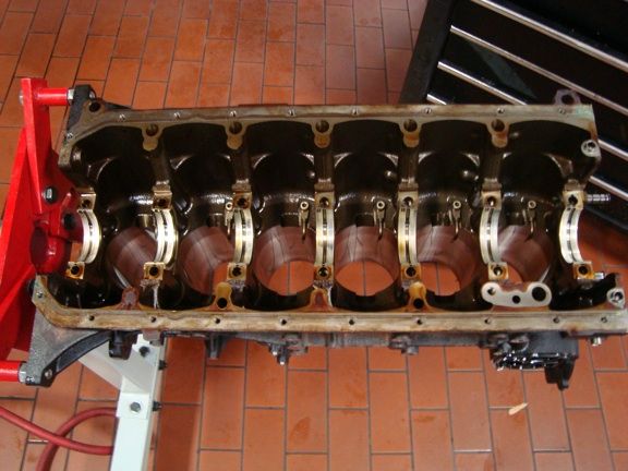

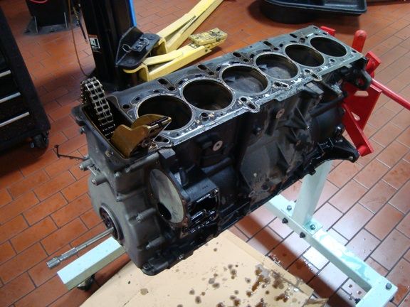

The the head
Next the rods and pistons
-George Hill
Old 08-05-2013, 07:58 PM
Posts: 1,088

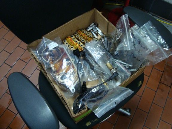

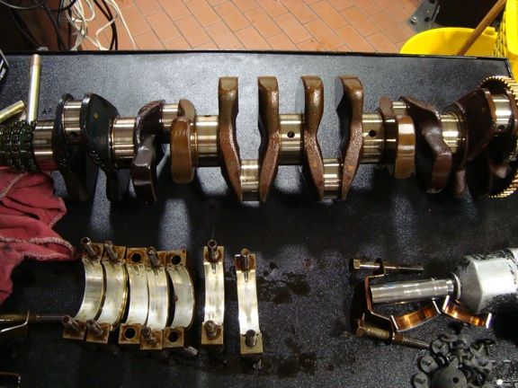

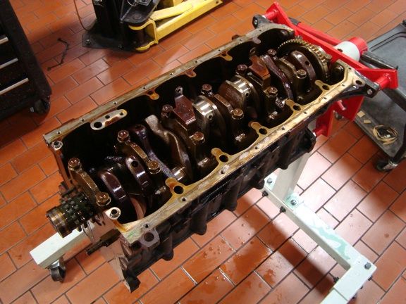

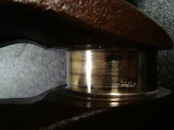

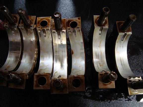

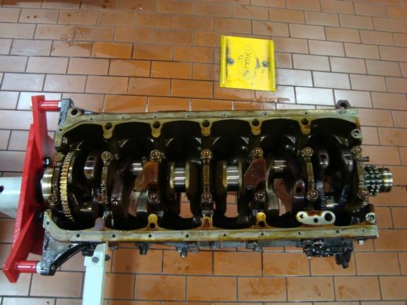

Finally the crankshaft
Main Bearings look good
Damage to the crank, which is really nothing at all. The speckling you see is material transfered from the bearing. The crank was good to go with just a simple polish job.
Parts bagged and boxed awaiting return of the parts from the machine shop.
