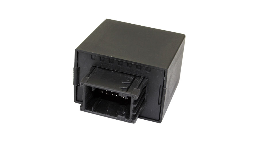

Anyone found a non load dependent replacement flasher unit that will plug into the original flasher unit socket?
I haven't opened up the flasher unit to look at the pin-out. Would it look something like this?
http://www.motorcycleparts-hornig.co...=900&Hoehe=496
tjs 04-18-2014 09:38 AM
yes. tjs
Groceryrun 04-18-2014 09:51 AM
This one will handle LEDs without the fast flash.
However , it will not self cancel ... you'll have to remember to cancel the turn signal yourself.
Flasher Relay for BMW K1200LT | BMW Motorcycle Accessory Hornig

Thanks very much sirius. I followed your link to ADV and Pool's solution. Per that information I removed my flasher unit, cut a single pc board trace and NO MORE PROBLEM! If I understand things correctly, cutting the trace re-programs the flasher unit. It is originally programmed to blink fast if a light goes out. After the cut it blinks 1x/second regardless of load.
