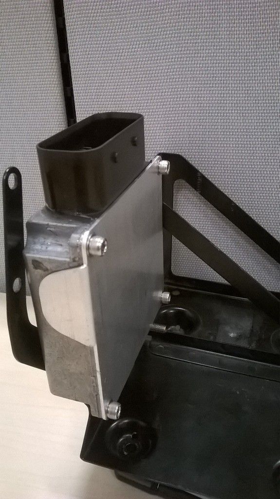

best modification I've made. my first attempt was done after A LOT of research and I followed some bad advice by removing the ABS unit with the electronics and cutting into the wiring to install a relay. DON'T DO THIS (you will lose the spedometer function - it was a pain in the a$$ to fix and do it right. The correct way is to retain the ABS unit's electronics.
If you are going to do this - PM me and I'd be happy to walk you through the details. Parts you need are the small hard line that connects the rear master to the rear line junction and a set of after market lines. I ran a double line from front master to each caliper.

I have the iABS delete plate made, if you are interested.
Here is the picture of the setup, keeping the electronics portion of the iABS.
Sorry for huge pictures, but again DONT CUT THE HARNESS!!!
Let me know if you have any questions.

I used a piece of the hard lines I removed to make a short line to tie the rear pedal cylinder to the factory junction block. This allowed me to use the regular Spiegler line. You'll need a brake line flare tool that makes a double-flare though.

Part # for non-abs brake line piece is # 34322335705 in case anybody is looking to do this Mod
