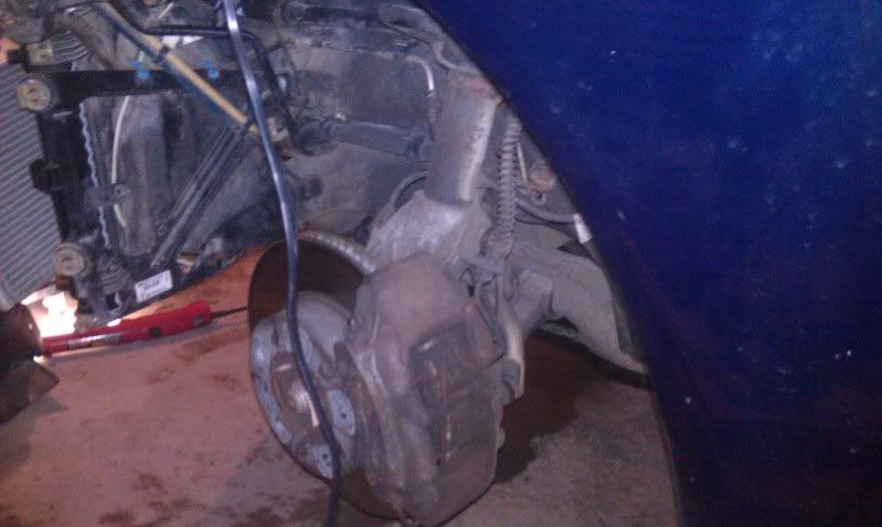

Busy weekend here:
-Saturday was a 12-hour marathon to replace the left radiator but today's drive to & from work (about 35 miles each way) didn't leave any traces of drips & the coolant is still topped up at the max line.
-Tonight was only about an hour to lay eyes on my engine for the first time enroute to cleaning the MAF !!!
Wayne's book has been great. Looking at the "Poor Man's Method" to add the trip computer, etc. because it was there as a project! Gotta check the option codes first.....
