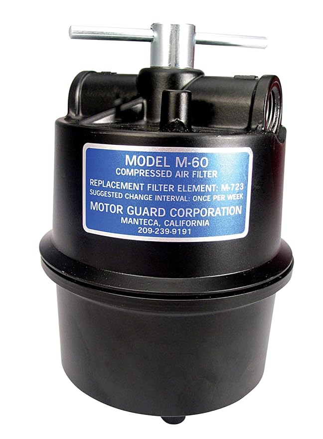

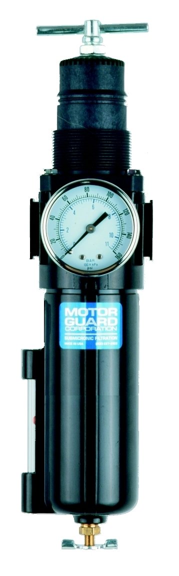

In my shop, I have an air dryer followed by one of those toilet paper filters.
https://smile.amazon.com/gp/product/B0009K6CQ2
https://smile.amazon.com/gp/product/B000WZYKAE
I just throw TP out when I’m through with it. So you filter and reuse?
