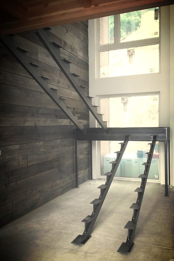

Needing some engineering advice on a center spine single story staircase for new inside construction.
Each tread will be made of oak 2 inches thick, 11 deep , and 38 wide.
The treads fasten to a steel structure. So, there will be full width fastener locations to p and bottom.
We want to have a clear span from bottom to top. ( floor to ceiling windows behind it)
So how thick should each tread steel platform should be? How wide and deep should the sawtooth steel center spine be?of course hand rails need to be installed
We want it rigid enough so there isn't the vibrations that come from thinner structures
Thanks

"We want it rigid enough so there isn't the vibrations that come from thinner structures"
That's not the most refined spec there. Perhaps find a spiral stair case that you like and copy it. ...or ping it with a hammer, record the note, tell an engineer that's the spec. D-flat, or whatever.
Just saying, everything has a natural frequency.

You only want one stringer (saw tooth) out of steel and the thread is cantilevered on both side made of 2" Oak? I am not sure if you can get around the vibration part unless its way over build, but that will look too bulky. I am not an engineer so take that with a grain of salt. I bet if the stringer is made nice and thick with a flange 24" in each direction a lot of the vibration will be eliminated.
The problem is getting your building official to Ok this because they will need to see the engineer's stamp and approval.

You don't specify whether or not you will have risers in addition to the treads. If so, they will add considerable stiffness to the stairs. Rather than make the center support out of plate, I would suggest you make it in a box section. The wider and deeper, the better. If it contains internal bulkheads, so much the better. I would use a structural adhesive on any mechanically fastened connection. You can also use the railing on both sides to substantially stiffen the structure, depending on how it's constructed.
I don't know if you are building this in a permitted project, you might consider getting an engineers stamp on whatever design you come up with.

I agree with the above, this is why drawings help, they are part of the design process and problem solving.
Right now nobody has any idea how all the parts fit together because it has not been drawn.
Plan view, elevations, sections and details in addition to any 3D sketches showing intent are necessary.
What you started out describing sounded a lot like what is built in Europe, our building codes will not allow for such artistry.
My feeling on this is you are perhaps building this in an earthquake zone, which means all bets are off. You better hire a structural engineer TRE Cup.

There is not likely anyway to not have steel showing. Instead, I'd incorporate steel as part of the aesthetics. W/o a conceptual drawing this thread is useless speculation.
We need to start here.

Are you trying to do something like this
Old 11-26-2018, 09:05 AM
Location: Los Angeles
Posts: 17,601
Yep, picture is worth a thousand words.
Join Date: Aug 2015
Location: Pacific Northwest
Posts: 2,455
another one
Old 11-26-2018, 09:08 AM
Join Date: Aug 2015
Posts: 2,455
And another
Old 11-26-2018, 09:11 AM
Join Date: Aug 2015
Posts: 2,455
Hope these help

I imagine they do, and I bet most if not all of them are not in the USA. We still have nosing profile requirements.
Good idea to crack open the code book and see if any of these meet code. Thinking 4-inch sphere above, and 6-inch sphere in triangle at the bottom especially, and of course you have to have a grabrail/handrail on at least one side (commercial is both sides).
FYI:
IRC 2015 changed/lowered residential riser max. ht., many older designs will need to be modified for more run length and an added riser. Just a head's up.
The engineering for a one-off can be intimidating. I suggest going with a manufacture that carries an engineer's seal on their deigns, then all you do is add the treads and hope you pass inspection. Some jurisdictions will bust your balls, other's just want a piece of paper in their files with a seal on it relieving them of liability. Every project has a different bar set for it, life is not fair.
You will need the connections top, middle (if there is a landing) and bottom equally engineered to take these point loads. Might end up with more than one engineer's seal.

I believe what you are referring to is called a "mono-stringer" or "single-stringer" or "center-stringer" type of floating staircase design (that might help with your web searching).
On the ones I've seen, the platforms that the treads attach to are relatively small, which is likely on purpose to help achieve the "floating plank" effect.
I can't help with the engineering aspect, but I do know there are several modular and/or pre-fab kits available out there.
You might look into going that route, as all of the engineering has been worked out and install is DIY-able.
Regarding vibrations, it's probably going to be a challenge to completely eliminate the hollow ringing/tuning-fork effect of that type of design (solid wooden planks attached to a steel box-beam, etc.) when in use. Anything you could use to isolate the planks from the beam would probably be a no-go. I've used an acoustic (sound-deadening) latex paint additive in the past on other applications that has worked well, so maybe that is an option for coating the beam with. Or, you might look into a pre-fab/engineered wooden center beam.
Also, if you haven't sourced the treads already, you might consider going a bit thicker than 2" planks. YMMV.
