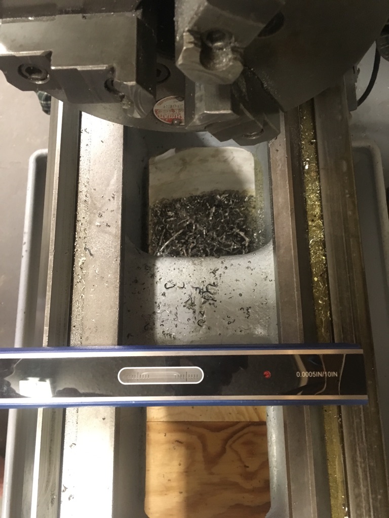

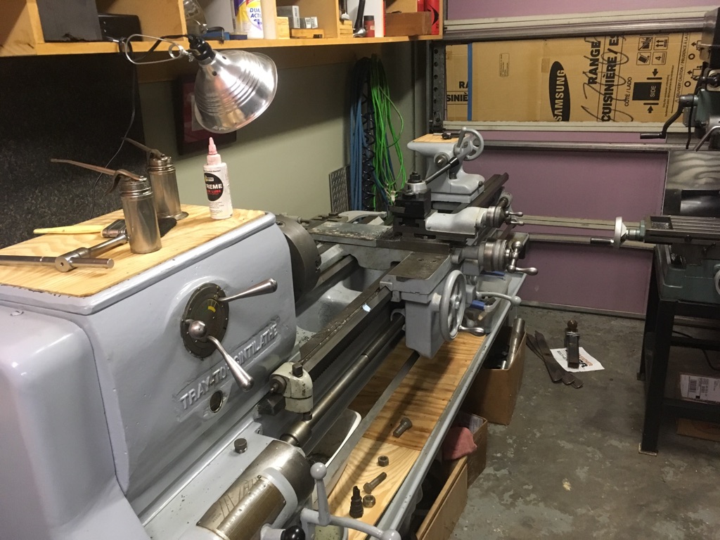

I have a old Cincinnati 15X60 lathe.. I use a Machinist level on the ways to make sure they are exactly parallel ... if there is any twist in the ways it will cause the cutting tool to cut a taper rather than a straight even cut. The level I have is accurate to .0005"/10 inches By taking readings from near the chuck down to the tail stock and adjusting the legs, you can adjust any twist out of the heavy cast Iron. Just adjust a bit, then wait awhile, then measure again... until you have it perfect.

"I have a old Cincinnati 15X60 lathe.. "
I'm jealous that you have room for a big lathe in your shop. I see you have a milling machine, too! Nice!
That pic is my home shop, My business shop has more space, but the home shop is more relaxing for me to play in.
Priorities. We make room for whats important to us... Same with our calendars and checkbooks. I like to have the ability to repair or make anything... Not that I will, or want to when the time comes... but I like to have the skills, and equipment always ready. It brings me a sense of purpose when I can help others or myself. Looking to add a TIG welder soon, but have to figure out where to put it.
