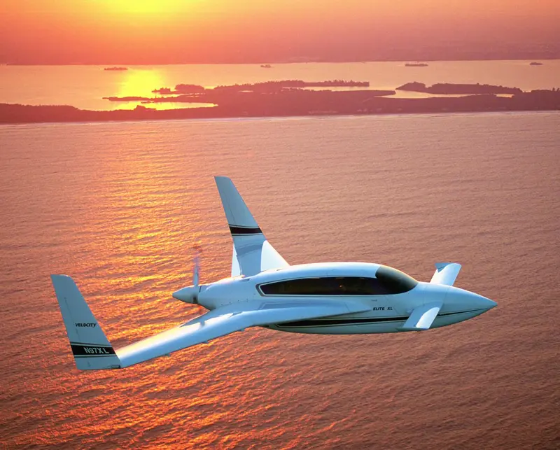

So stuck at home, my thoughts are wandering to when I can finally purchase an aircraft for myself. I have been thinking of different aircraft I would like to fly and one day perhaps own.
I am especially intrigue by the Velocity aircraft
Looking through the regs, it looks like I wouldn't be able to use it because of where I live. basically under the New York Approach airspace in northern NJ.
(c) Unless otherwise authorized by the Administrator in special operating limitations, no person may operate an aircraft that has an experimental certificate over a densely populated area or in a congested airway. The Administrator may issue special operating limitations for particular aircraft to permit takeoffs and landings to be conducted over a densely populated area or in a congested airway, in accordance with terms and conditions specified in the authorization in the interest of safety in air commerce.
Am I understanding this correctly, that I wouldn't be able to own this or fly this to my base airport of White Plains HPN? Thanks in advance.
That refers to the test phase only.
All home-builts (Experimental placard) will be limited for the first 25+ hours (or nearly double that if your engine/prop aren't cert'd units) for the initial test phase. After completion of the build, you basically become the "chief test pilot" and need to demonstrate that it is airworthy (or you can find/pay someone to do it for you). During the first phase, that means no pax, VFR only, and no populated/congested areas, etc. After that process is successfully completed, you are cleared for normal (part 91) ops.

The regulation you found does indeed apply to Amateur Built aircraft, and the later statement that the regulation would not be applicable following the initial test flights (phase 1) is only partially true.
Once the aircraft is ready to fly and the FAA or a designee inspects the aircraft to issue the Special Airworthiness Certificate, they will generate Operating Limitations that are attached to the certificate and must be adhered too for all operations. The current wording for Phase 2 flight area operations is:
26. Flight over a densely populated area or in a congested airway is authorized for the purpose of takeoff or landing; or unless sufficient altitude is maintained to make a safe emergency landing in the event of a power unit failure, without hazard to persons or property on the ground. (55)
FAA order 8130.2J is the current guidance for certificates, it does change fairly regularly so today's policy may differ in a year, but the above wording is current as of today.
I have been a FAA Designee since 2000, and I am a fan of the RV series. Easy to build, operate, inspect and fun to fly. If you have specific questions, fire away. Matt
Hey Matt,
DMIR/DAR? I would defer to your judgment/info, but that is not exactly what was said in my later statement. The OP's question was referencing the airspace limitations applicable to Experimental home-builds.
AFAIK, those operating limitations regarding airspace, (and pax, flight rules, radio ident, etc.) are only applicable during the test phase (phase 1).
For all intents and purposes, the current operating limitations for "phase 2" ops (the remainder of the A/C's service life), are the same as other type-cert'd A/C under part 91...unless I'm missing something?

Hello, I am a FSDO and MIDO DAR.
There are about 25 limitations that carry over from Phase 1 to Phase 2; no intentional parachute jumping, towing, use for compensation or hire, ATC notification requirements, instructions for maintenance entries, etc., that are not levied on other part 91 operators.
Amateur built aircraft are great, more than 30 thousand and counting, but - they have limitations and they are all different, even RV's built side by side. EAA membership and participation is a must to get the most out of the education and recreation aspect of the build process.
