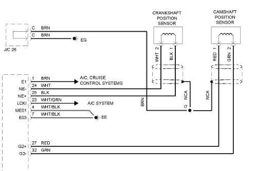

The CAM sensor though has me baffled too. Take a look at this:
If I disconnect the cam sensor connector (right behind the radiator hose) and try to start it, ECM does not throw a DTC. <---- odd.
But, OEM wiring diagram shows it a bit different. The diagram shows only two wires sensor side. So what's that 3rd wire for?
HARNESS (female pin connector)
red--------green----green-black
white-----green--------red
SENSOR (male pin connector, the bottom connector in the sensor pic which connects to harness)
Using ohm meter (quality Southwire DVM, I also have a Fluke, etc) on sensor pins only (switching meter leads on every pin set, etc). Is this a good or bad sensor? Maybe its a powered Hall sensor and not a simple 2-wire coil pickup? "green" below is more like a darker green, etc.
White+ Green- = 0ohm
White- Green+ = 754ohm
Green+ Red- = 451ohm
Green- Red+ = 1126ohm
White+ Red- = 0ohm
White- Red+ = 1892ohm
https://i.postimg.cc/FHx3Zbnq/cam-sensor.png
https://i.postimg.cc/yxqDBWbc/cam-sensor-pic.png
john70t 10-17-2020 10:39 AM
(apologies for having forgotten most of my book learning from 20 years ago. layman here. I'm just throwing spaghetti at the wall.)
Aren't there:
1. pulse type (piezoelectric)
2. hall- effect (magnet transfer) minimum 2 wires could be 3 i think.
3. blade-interuptor (magnet or light/laser) minimum 3 wires
per the first diagram:
I'm guessing that's a powered Hall and white/black is power in a loop off the ECU. Probably 5-9volts.
NCA/BRN leads to J/C 26 and then to "EG" ground. That could be the signal output.
The second pic shows a red wire. But you have a green wire...
Is that the immobilizer?

The J/C 26 is a ground plane (shield) around the sensor. Well, it's shown like that in the schematic. You also notice in the 2nd pic that a bare wire comes out of the wire bundle and is crimped to the metal housing. I think this too is also a shield wire that only shields that extension wire between harness and sensor, etc.
The 2nd pic is not immobilizer, it is the CAM sensor in it's holder/mount with the extension wire. The extension passes through a rubber grommet in the upper plastic cam gear cover, where it then connects to the harness connector.
Lexus4321 10-18-2020 09:18 PM
Skip my Q about the cam sensor.
Little not-so-known fact, Toyota made two gen's of GX's for NA market, the GX470 (2UZ-FE) 2003-2009 then came the GX460 (1UR-FE) in 2010.
Here's the deal though, 1st gen got some major changes in 2005, including dual vvt-i. Along with that the types of sensors changed to.
2003-2004 , then major changes in 2005, yet they still call the 2003-2009 the "1st gen GX470's". In my opinion 2003 to present is three gen's of GX's.
So, what does it all mean? It means the wiring diagram I was looking at is for the 2003-2004 GX's, those vehicles use 2-wire cam sensors !
Lesson learned.

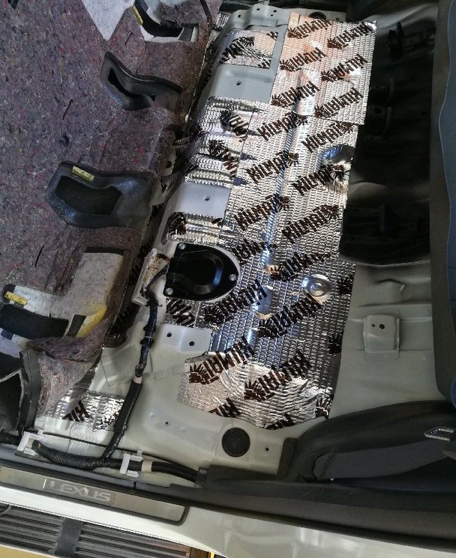

Got the cut mess all back together, even wiped the weld area underneath with an epoxy to help prevent rusting.
Then added some KilMat under the feet and seats.

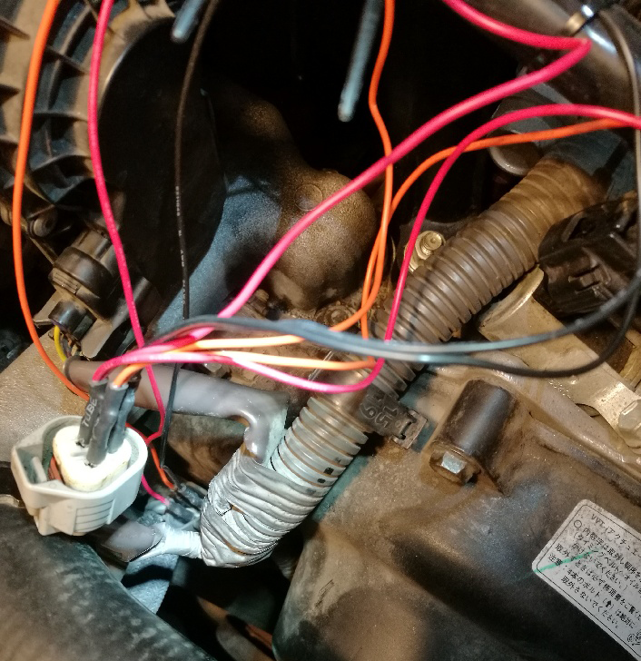

I made some break-out patch wires so I could probe cam sensor w/o stabbing the wires.
https://i.postimg.cc/7LVWsg86/camwires.png
cam sensor appears to be ok.
