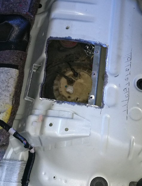

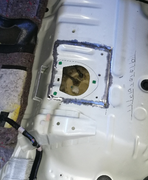

Here's the prep & cut. Used a fine tooth blade, and had to drill out 3 spot welds. I did manage to break a clip that cannot be replaced on it's own, but I will deal with that. Notice how the cut on right is far enough back that it's in the hat channel so I did not need to cut the edge of the hat channel off. This looks like enough room, but if needed I can trim the edge of the hat channel.
I am waiting on some parts and ring tool to finish the pump swap, but going back to TIG'ing it, I think for safety reasons I will TIG the seams 100% and then TIG tack back where the spot welds were. Then will clean/prime the area (underneath I can reach with my hand, so maybe a wipe of some sort to protect the metal) and then just a quick shot of white spray. Like it never happened

Old 10-07-2020, 02:23 PM
Join Date: Sep 2009
Location: North of You
Posts: 9,160
It would not worry me to tig weld that.
Does it even need need to go back in?

I do hwy driving. A at-speed crash or rollover could cause the plastic tank to rupture or lines to rip off, don't want fuel easily spilling inside the vehicle.
So for shear safety reasons I will completely TIG it back like it never happened, etc.
I just did not want to muck around with hoses/clips/connectors of dropping the tank. This is a 14.5yr old vehicle and it's showing signs of dry-rot on plastics and stuff, more so outside than inside. So to avoid that headache I went this route, etc.
And while I have the carpet up, will add some 50mil sound deadening mat to make this boat a tad more quieter inside.

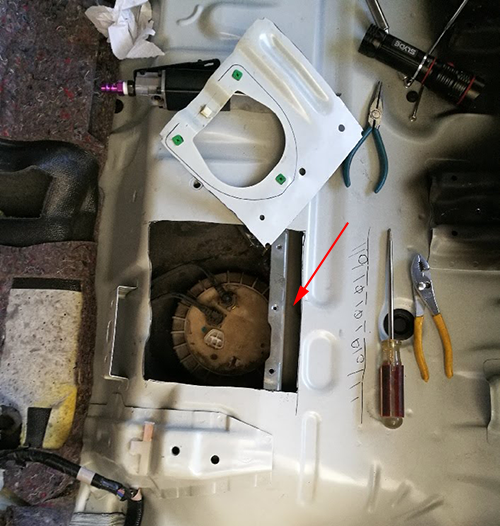

Good news, pump canister made it out w/o additional cutting. My initial guesstimate at the opening size was just enough.
The float sending module looks like toast, so a new one will go in.
