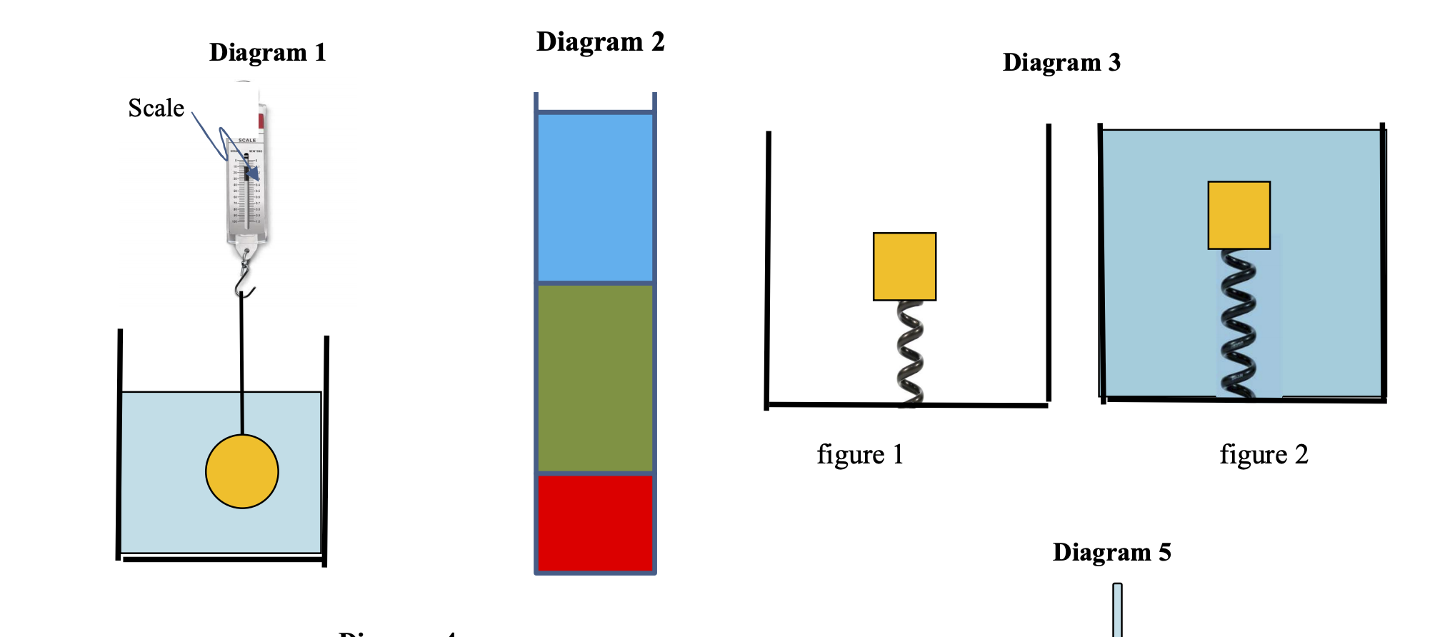

Based on the bolded portion, I assume you mean, the ship is COMPLETELY flooded with no air pockets, and no materials that would normally float (wood, foam, etc... for instance) You want to know if the weight of the materials is the same.
Originally Posted by id10t (Post 11736146)
Nope. Just increases density of the water - has no effect on the mass of an object or the gravitational pull on it. 33 foot depth of saltwater is about 34 foot of depth of freshwater is about 1atm pressure (14.7psi)
Actually, if it's possible to weigh a material at the bottom of the ocean, then because of the relative densities, it would absolutely have a positive (upward) force applied due to bouyancy when submerged in salt water. THere would also be an increased force applied downward (gravity) that is greater than the force applied to the same object at sea level.
It's that ability to weigh an object under water which enables us to measure the specific gravity (relative density) of substances that can be submerged in water.
Based on the previous information that I found that says that the effect of gravity on an object at the top of Mt Everest is 0.25% less. I'm going to say that the effect of gravity on an object at the bottom of the deepest part of the ocean may be similar but opposite. If you then look at the specific gravity (relative density) of steel, 7.8, then steel submerged in fresh water will only weigh about 87% of what it weighs in air. If submerged in salt water, the weight would be even less. The mass hasn't changed, but there is a force exerted on the object by water which causes it to weigh (based on a scale of some sort) less.
If you were able to put a ship in dry dock and weigh it, and then you were able to sink it in the ocean, so that it was just barely covered in sea water, and you had a way (no pun intended) to measure the weight of the submerged boat, it would weigh measurably less than the boat in dry dock (assuming completely flooded with no air pockets. That's exactly how specific gravity is measured, by weighing objects before and after being submerged in water. Changing from distilled water to salt water would then make a difference that could be as little as 2.5% or as high at 7% when 10km down.

hbueno 07-06-2022 02:06 PM
F=ma
Weight is force F, which is the product of mass x acceleration.
The weight is less underwater because the buoyant force is pushing up while gravity is pulling down.

I agree and disagree.
The mass doesn't change. Yes, the bouyant force is another force acting on the object in the opposite direction to the force of gravity. The weight will change by some (very small) amount based on "altitude" (whether it's up or down).
But certainly if you try to measure the weight of the object, it will measure differently at the bottom of the ocean than it would in a hole in the ground that was as deep as the bottom of the ocean due to the bouyancy.
The first definition of weight on the Merriam Webster website is, "the amount that a thing weighs." If you then check the definition of "weighs," the first definition is "to ascertain the heaviness of by or as if by a balance."
Using those definitions, the bouyant effect of a liquid on an object would affect the weight of the object. If you consider weight to be "mg" (mass x gravitational constant) and you know the mass (no need to measure it) then yes, the weight using that formula would not change unless either the gravitational constant changes or the mass changes.
Technically, our weight probably changes whether it's midnight on a full moon or midday on a new moon because the gravity of the moon does impart some (albeit REALLY small) force on us. Clearly there is some impact from the gravity of the moon or we wouldn't have tides. Just another funny to consider datapoint due to forces.
