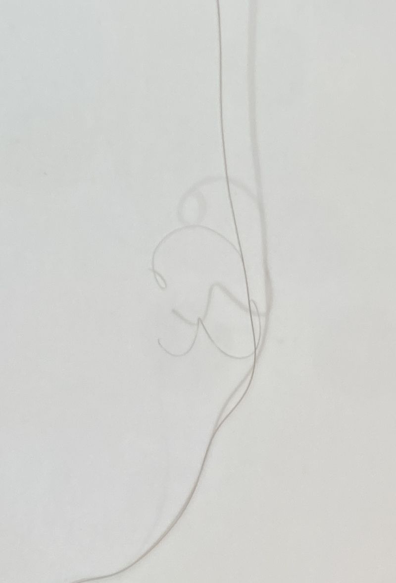

I did it. I got one of our Shuns ^^ hair whittling ^^ sharp. The problem is that I haven't been putting an acute enough angle on the blade.
I've got these 2 stones
And some of this stropping compound
I've also got a digital level. I've been sharpening at probably 20-25º. I dropped it down to somewhere in the 15-20º range using the technique of the guy that made the video above, and that did the trick.
The 2 curls are hair that was "whittled" off of the hair by laying the hair over the blade and pushing the blade. My knives aren't quite as sharp as his. I need more practice, but that's a step in the sharp direction.
Finally, getting knives SHARP!
