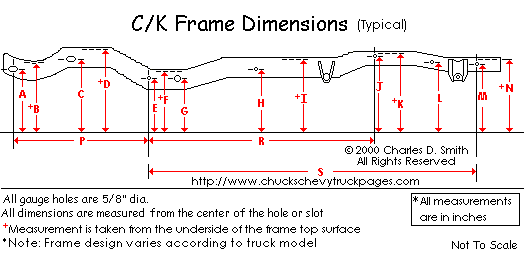

Okay, I did some googling and found a site that has chassis info for '73 - '87 Chevy trucks. Here is the link...
http://www.chuckschevytruckpages.com/framespecs.html
And here are a few pics from the site...
Like I said, I live in a unibody world. So this stuff seems utterly alien to me. Lots of Porsche folks stiffen their chassis using semi-tube frame structures. But this ladder frame thing is Model T technology. I assume the goal would be to connect the suspension points and tie them in to a full roll cage. Then somehow link it all to the engine and tranny mounts and the body mounts? Damn, this thing makes no sense to me.

The S-10 is not a C/K family vehicle, those are fullsize.

If it's rusted out around the cab to frame attachment points you're all done. If the frame is starting to erode you're done. You need to identify where it's rusting and either patch it if it's small or toss the whole thing and get a different truck. There's no way to reinforce it to overcome structural rust. A cage isn't going to make it any safer.
If it's that wasted it's smarter to toss it and buy another - an 87 S-10 is CHEAP. The money you spend on one that isn't rusted out will seem like a pittiance compared to the hours you'll have invested cutting, patching, rewelding - and spending money on supplies, frustration, etc. etc. and you'll have spare parts from both too.
