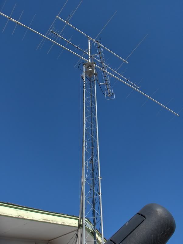

I will be selling alot of Ham Radio gear this year, and there are a few items I have no idea who made them, or what they are used for (applications), or what they are worth. So I figure I'll start a thread, and come too the experts for answers.
First up is the antenna tower, with antenna's. I would like too know what type of tower this is. I would also like too know what type of antenna's these are.
Thanks.

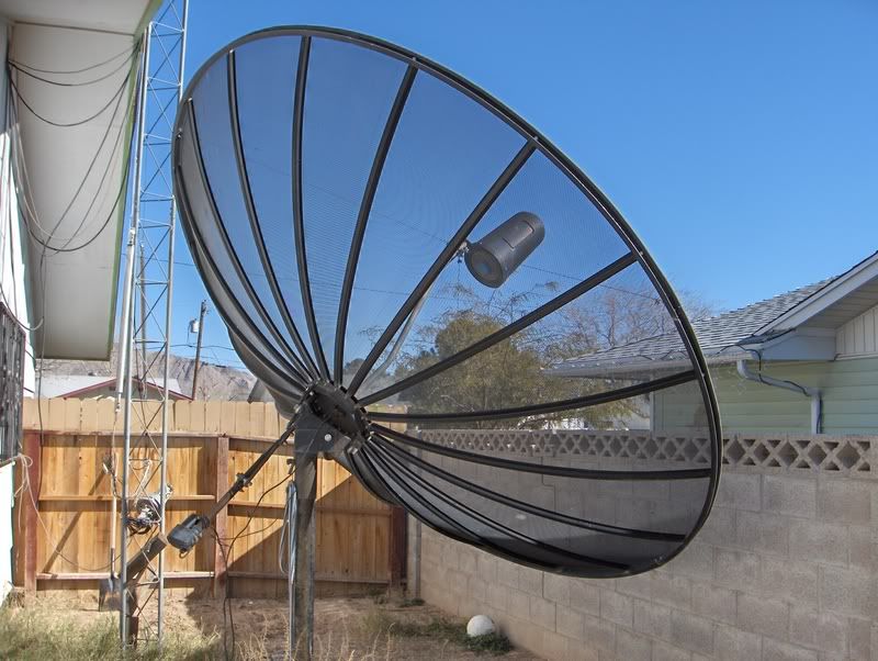

Also some info on the dish.

Doubt that you will get much on the satellite. Its an old "C" band model and while they are used these days the newer DirecTV and Dish models are a lot easier to fuss with.

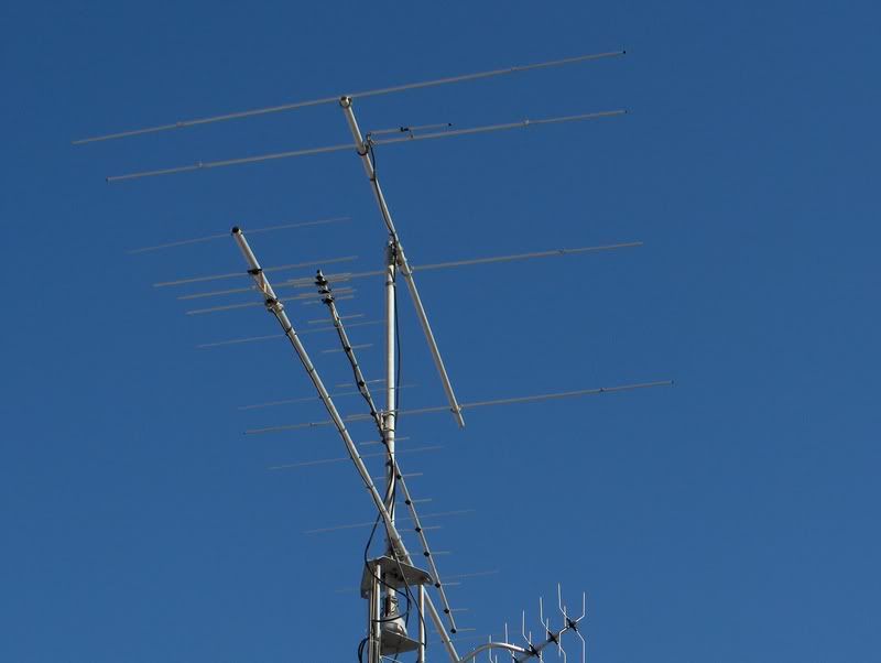

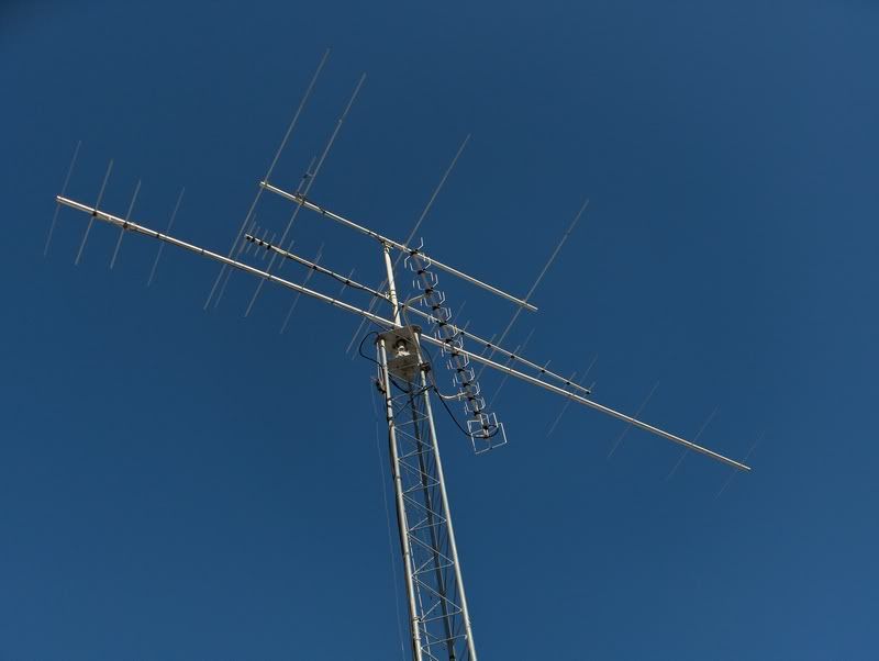

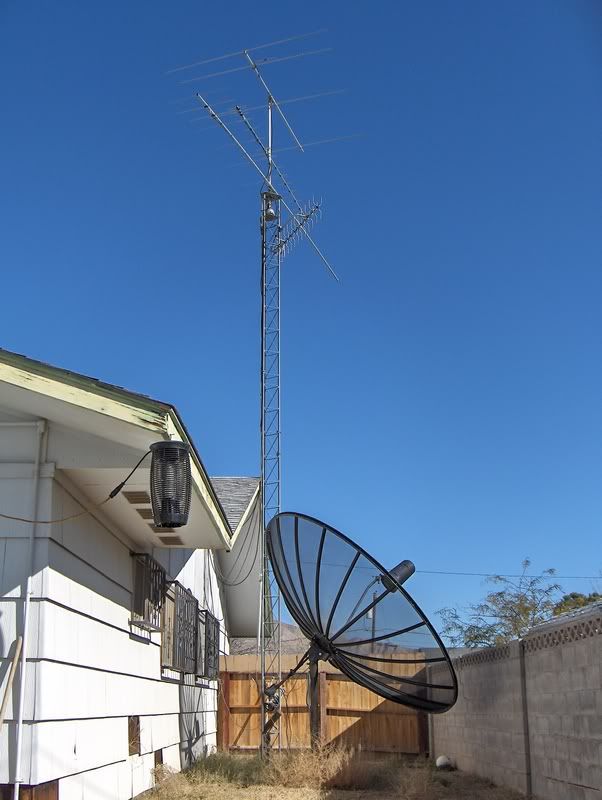

To me it looks like you have three joints of Rohn 25G tower there, and some VHF Yagis plus a 6m on top. My monitor is not too great, do I can't tell what type of rotor you have up top, plus you have one just "hanging around" in the bottom section as well
I would have used a house bracket on 25G as well, seeing that is is "non-guyed"...Not TOO much wind load for 30' though. (I had a TH3mkIII plus a 2m & 440 @ 30', quite a strain in 30mph winds).

When its not windy, I'll climb up and get names and model numbers off the rotor. The rotor thats just "hanging around" has markings that say TRA - 4 (with a 2 under the - ).

Bill, you should not have problems finding someone to take the antenni off of your hands locally. And 25G is not cheap these days either. I see they went with a top plate and a short throw to the shelf. I always liked a tapered top joint, thrust brearing on top, then bring the mast lower into the tower. Check around, some hams might even disassemble it for you as a trade-out for some of the parts. We took down many commercial installations long ago, and got tons of 25 & 45. Great towers still.
