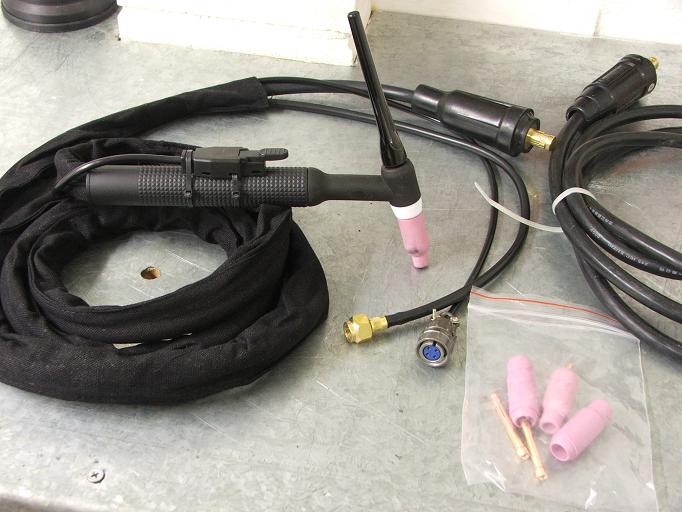

TIG stands for Tungsten Inert Gas. Here you strike an arc with a hand piece that has a tungsten tip. You then feed the welding rod into that arc to complete the welding process. Inert gas wash the work area to prevent contamination.
Each of these is dependent on an arc to effect the weld.
Stick(arc welding)
MIG
TIG
